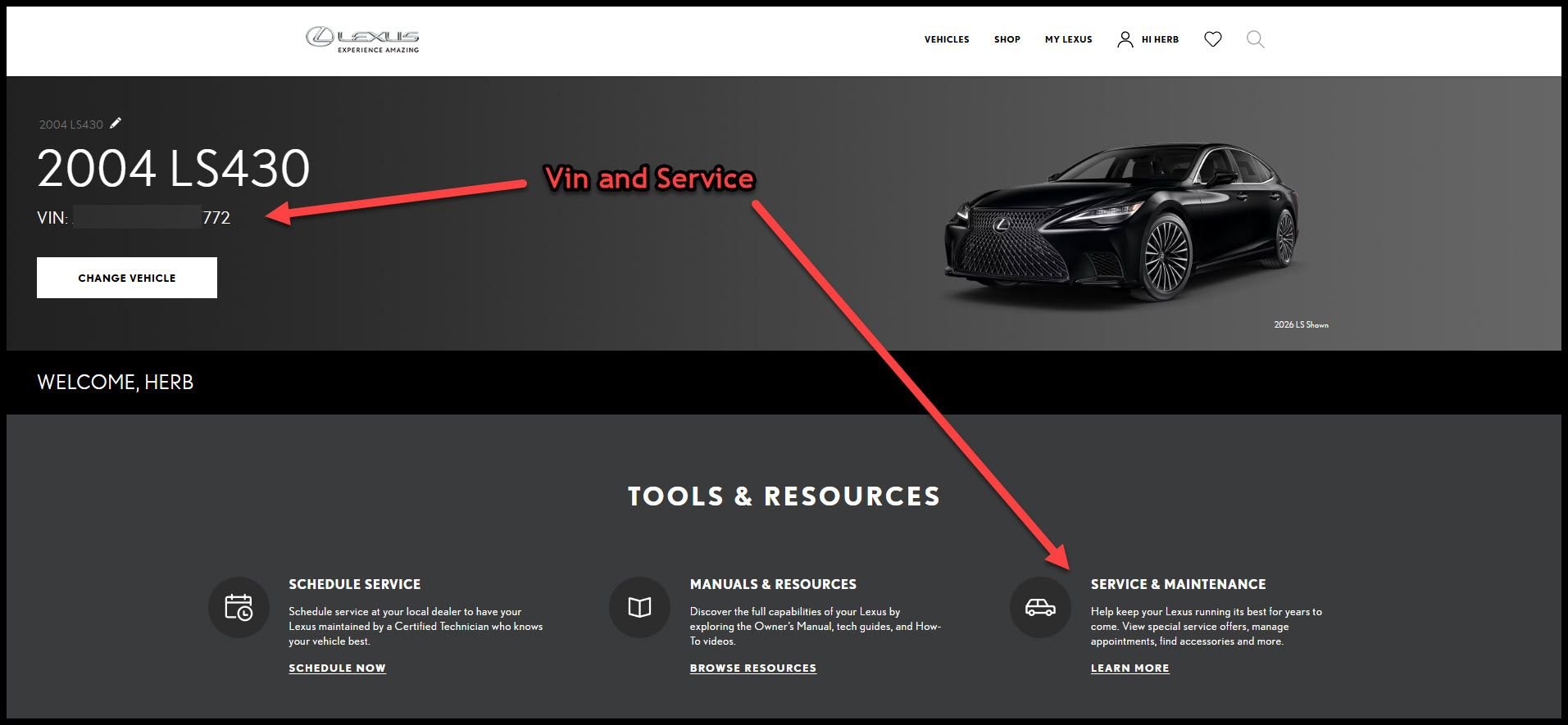

Originally Posted by Nex3090
I am inheriting a 2004 ls430 with <100k miles. The service history is in files I won't have until after intake possession. What are the first things I should look out for? It's in great shape, garage kept, southern. Just want to treat it with as much respect as I can and keep it going. Will be about a once or twice weekly driver (I have a 50 mile total commute.)
You can still log onto Lexus.com, enter the vin in your garage (the place on your profile to add a Lexus) and then visit the service history if the car was taken to Lexus.
