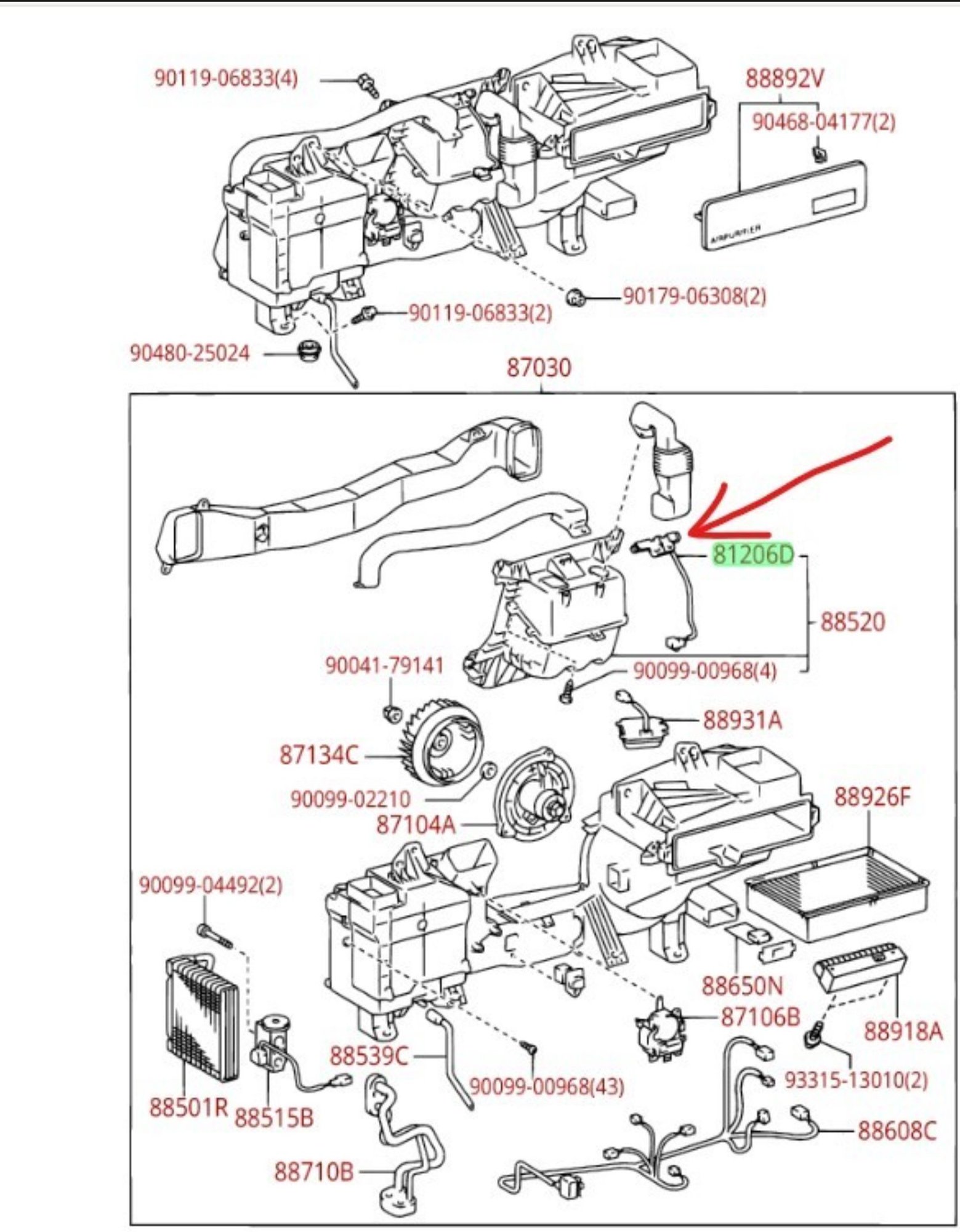

This is from Lexus parts. This is the Xenon air purifying light assembly. On Lexus parts it’s available for roughly $38.

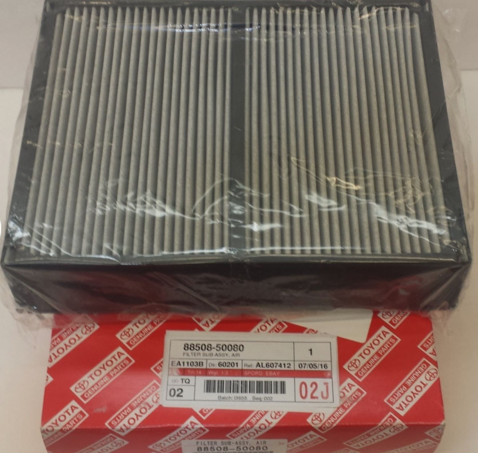

I saw what appears to be a rear evaporator in the parts diagram, lower left, 88501R. But I have never been under the car to look for AC lines. Sorry. The part number for the OEM rear air filter is 88508-50080. Photo attached. It comes with the plastic frame and is a drop in replacement.
Looks like it's part number 88508-30110 for the 2003 LS430 although the descriptions shows it fits a 2003 on the Bell Lexus site but not on Lexus parts now. It is on sale at Bell so I'll order 88508-30110 from them.
