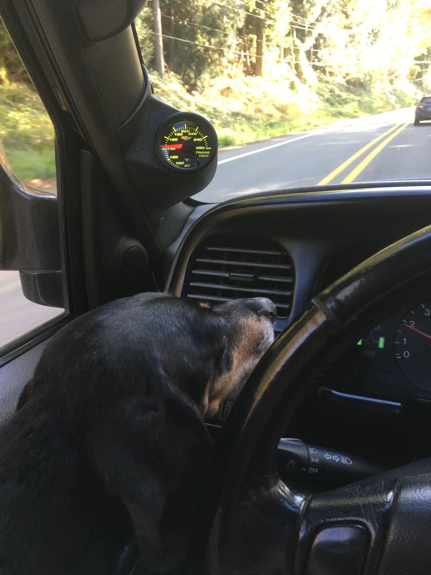

I don’t know if this helps w/what you are doing, but maybe this helps. Several years ago I needed to make an A-pillar pod for an SUV of mine, for a trans temp gauge. I bought generic ones off amazon or ebay for a few bucks (bought multi pod one). Cut it in 1/2. Took that part and heated it gently in the oven until just soft.
I pressed that on my a-Pillar until it re-shaped to fit it. I used the extra bit to get the technique right, then the remaining bit to make the final one. You might be able to make a reverse mold this way, then scan it.
