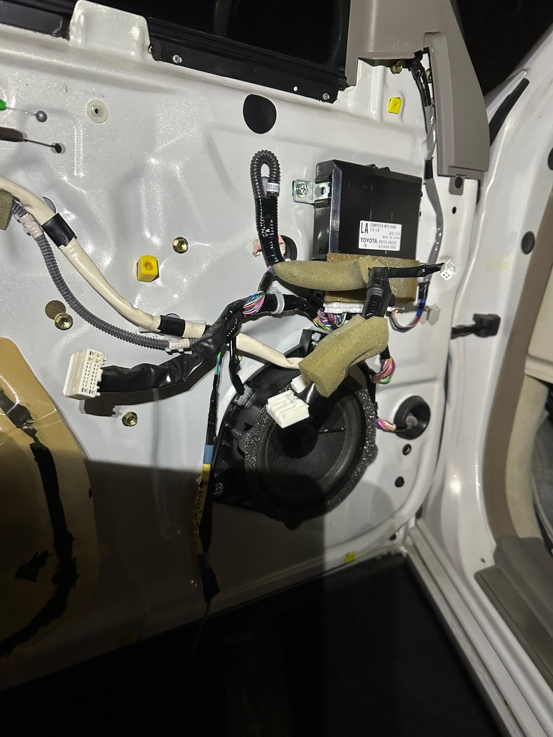

Update.
So I replaced the entire door lock actuator assembly myself, and now the door finally closes again.
I haven’t been able to drive the 430 in so long because of the broken latch.
After further inspection, a blue plastic thingy with a spring attached to it did break, thus not allowing the latch to engage with the door striker.
The job isn’t hard, it’s just a bit time consuming and you have it be careful when removing and reinstalling the door panel, including the unplugging and reconnecting the wires.
At the same time I installed some sound deadening material, including felt padding inside the door skin to make the door feel even more solid and quieter.
So for anyone in the future that encounters this issue, you HAVE to replace the actuator unfortunately.

But it’s my guess, probably not. Reason being is that I believe the black box which is the MPX body control module is different on the non soft close doors LS 430’s. The white cable connector is what plugs into that module which controls the door locks, alarm feature and I’m sure the soft close feature which now finally works on my car.
Check out the pics, also if you zoom in on the picture of the actuator, the little blue plastic piece on the left is what broke. A small spring was attached to it and that was dangling loose too
The job wasn’t too difficult, it just takes time and patience. Also now if another door in the future breaks a latch, I know what to expect. I really was surprised on how huge the actuator is. And it would have been better if one could replace the latch by itself instead of having to replace the entire assembly.
