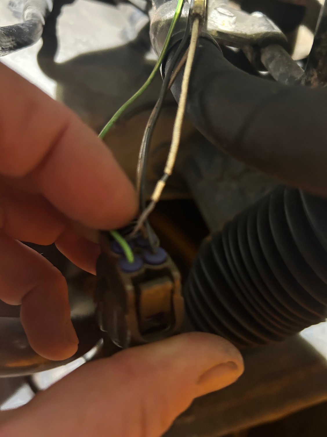

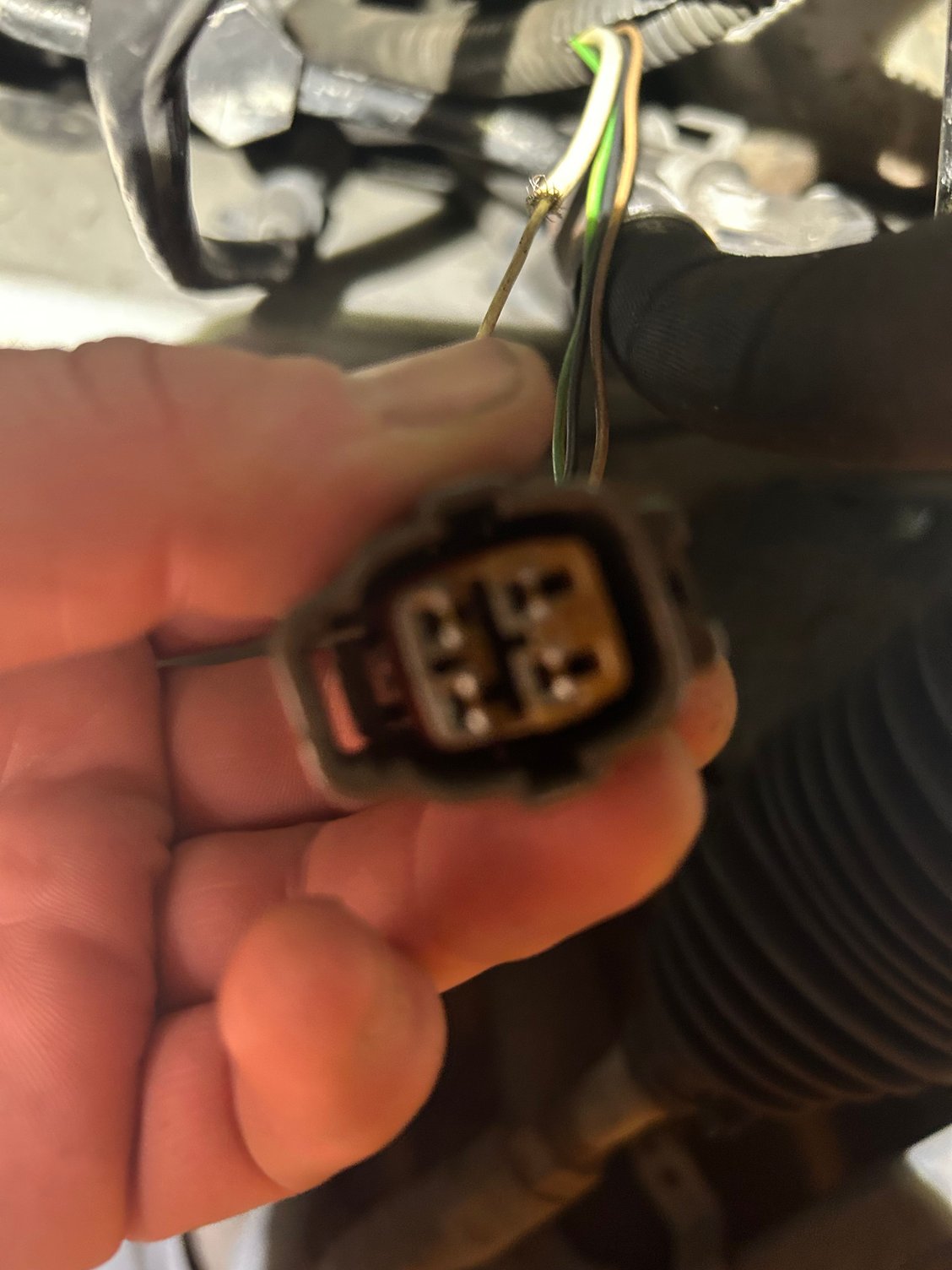

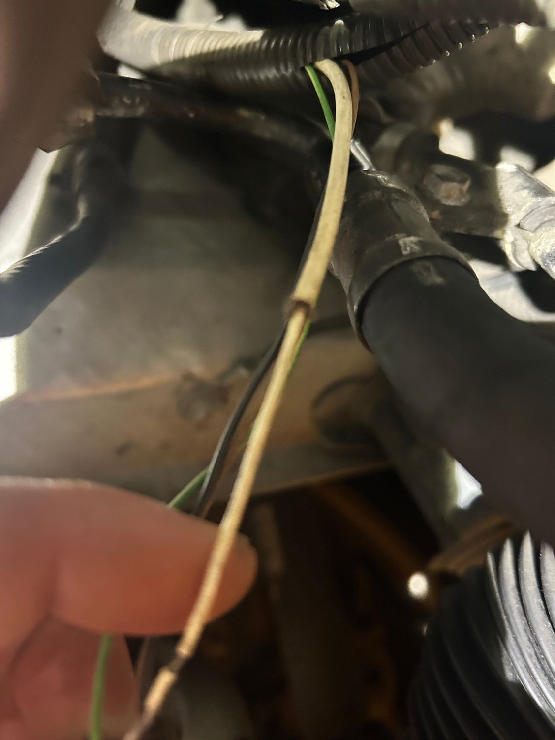

Last night I got underneath to check alternator connections just to be sure. Just behind the alternator is a 4 pin connector. It looks to be bracketed on what I think is the rear sump oil pan baffle (stamped Aisin 10020). The wiring is in the same plastic sheath with the alternator wiring and appears to run to either the passenger side VVT sensor, the coil packs or possibly the MAF sensor. Apologies that I cannot be more precise.
Anyway the wiring looks to be worn and I am curious if this could be the source of my problems?
Pics attached in post below (having trouble attaching in this post -pauses at 90%)
Thanks in advance for any help.
