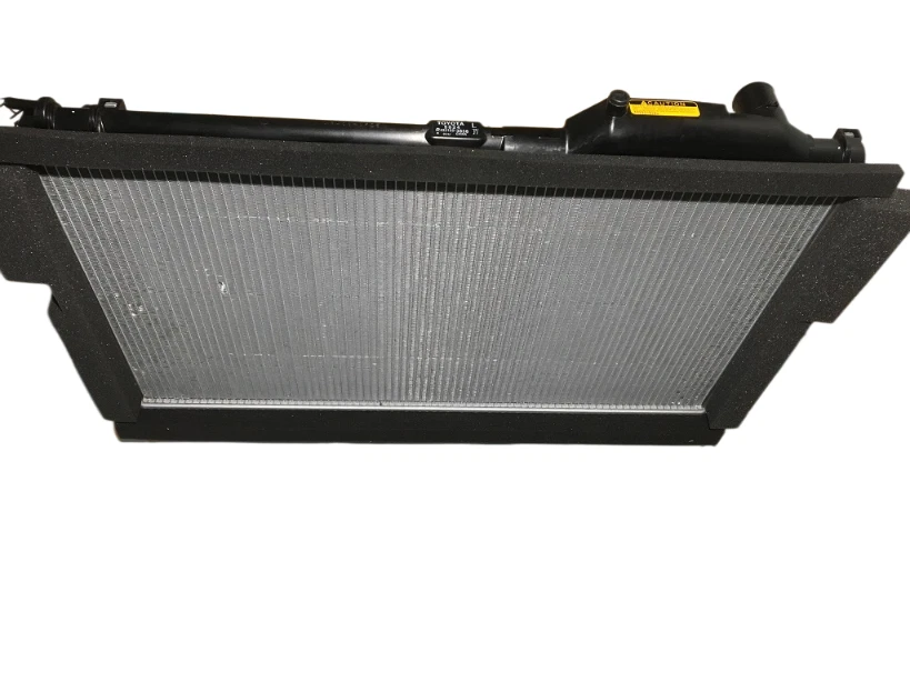

Originally Posted by alextv
Take a picture of the top of the radiator so we can see what you are talking about.
not my image but this is from another forum and mine looks identical (in the UK). The only other forum posts I see mentioning radiators are US/Japan models that have the radiator cap and expansion tank close to one another. I can take some pics of mine to show the whole thing and where the expansion tank is when I finish work

UK cooling systems are only filled via the Reservoir.
There is a screw-plug at the top of the rad but I believe it is there so testers can fit pressure testers.
https://i.ebayimg.com/images/g/OOIAA...5/s-l1600.webp
You can unscrew that bolt from the top of the rad, but don't do it when the coolant is hot.
If the coolant reservoir is at the Full mark (check the level by removing the Reservoir cap and dip a stick into it) and it's still overheating then you have a failed water pump or possibly a Thermostat that is stuck closed.
However, the most common cause of this issue is the staining of the Reservoir that leads people to believe it is Full when it is in fact empty.
You can replace the Reservoir with a new one, or just check it regularly with the stick.

Thanks for providing picture I guess the pressure cap is on the expansion tank. As Boomer mentioned plug in top of radiator is a place to do pressure test which I would do and tell a lot. It could even be your pressure cap.
