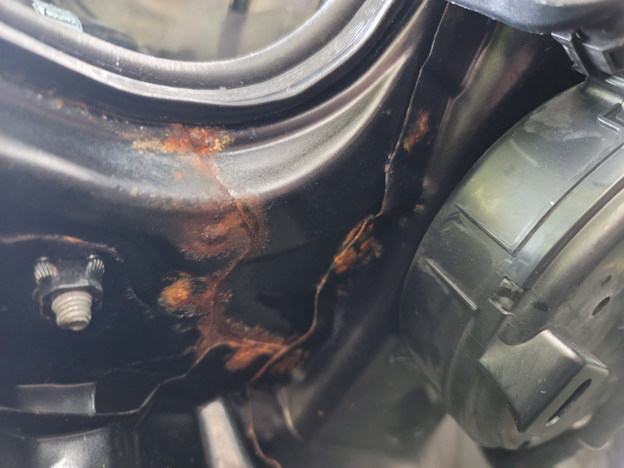

Just pulled all trunk linner out, me got inside, wife garden hose the trunk. The leak is from the chassis weld line as shown on the picture where rust rather badly.
I am unprepared for this cause of leak and applied some silicone sealer on it
Anyone experienced such leak?
Yes this is a common failure on older cars. Your repair will work but rust never sleeps ideally that should be etched with phosphoric acid (like Ospho) then have rust paint applied.
