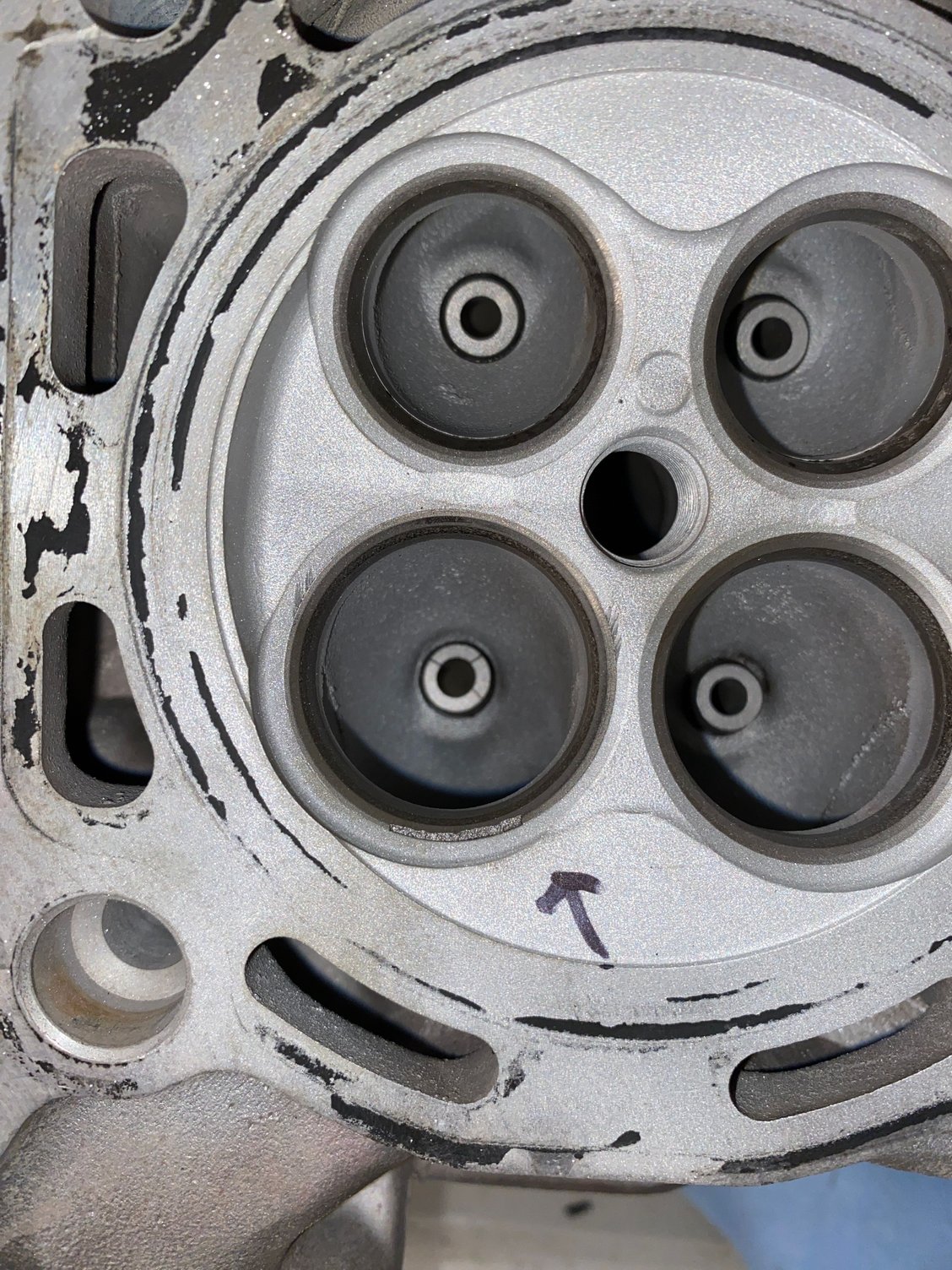

I posted here a few months ago about a possible head gasket failure and very rough idle/misfire. Finally took my cylinder heads to a machine shop and.... one of my valve guides and seats broke. Back most intake valve on cylinder 8 seems to have let go from its keepers and dropped into the cylinder, which explains why it was bent when I took the heads off, and definitely explains a rough idle, so maybe I never had a head gasket failure?? Not sure if my thinking here is correct or not.

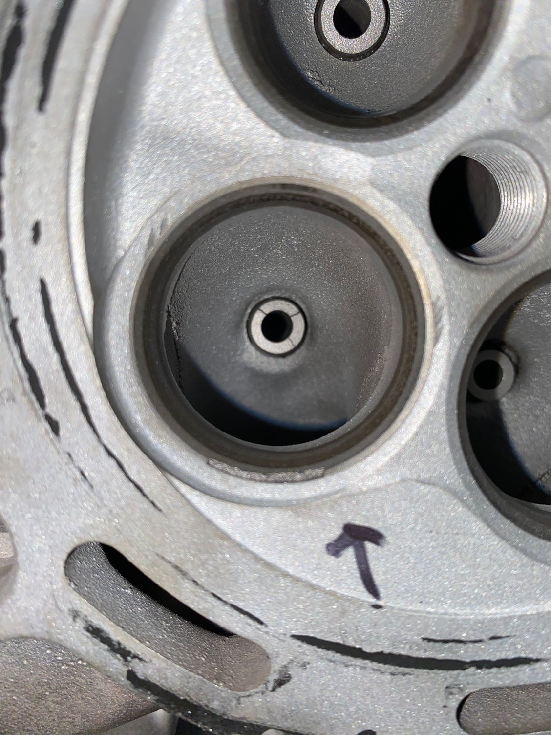

I have attached a picture of the guide and seat. There are three large cracks in the guide and a part of the seat is chipped off. Machine shop said they would only do a complete rebuild not just the seat and guide for $1900 for both heads, not too bad but to me this is time for more DIY (which is the goal of this project, do as much of it as possible myself to learn). I searched online and 3UZ-FE has press fit valve guides and can be removed. Not sure how I would remove the seat though; since it is already chipped would I be able to carefully hammer it out? As for the valve guide, it seems I would be able to hammer it out from the top down. Has anyone done any of this work before, or know of any good videos/resources for first timers?
For a new valve guide and seat, I just looked up LexusPartsNow and they are sold online. However there are two valve guide options. One is STD and the other is O/S 0.05, which I am guessing means oversized by .05mm. Should I get the standard one? (Screenshot attached)
Also if anyone knows of any good machine shops that can do smaller jobs like a single valve guide and seat near Austin, TX please let me know! Thanks for all the help and look forward to any advice.
Valve Seat Chipped

Valve Guide Cracked
Valve Guide Cracked

Before you think about attempting this get a hold of the factory service manual so you know exactly what is required. You're going to need a pile of tools and gauges to do the job.

I would try to determine why the guide broke in the first place. You don't want this to re-occur.
You use the oversized guide if the bore for the guide is more than what's specified in the FSM. If the bore is out of spec, the bore may need to be reamed to fit the new guide.
You also need to inspect (measure) the valve stem of the valve that's going to be installed in the new guide. It doesn't make sense to install a worn out valve into a new guide. Excessive stem/guide clearance can cause issues at the seat.
As far as the seat goes, there is no replacement instructions in the FSM. However, they're in the parts catalog, but are NLA. An engine parts distributor should be able to come up with a seat insert that will work.
Based on whatever the mileage is on the engine, you might be going down a rabbit hole that ultimately ends up being a rebuilt head.

This is not a task for a DIY. A replacement guide, valve, and seat is not expensive. The tooling required to do it is. The job scope is not very difficult for a machinist, quite simple actually. No machine shop is going to only replace the one guide and install the seat and only cut that. They are going to want to do all that plus a valve job on the cylinder heads, etc. I don't know your location, but whoever told you $1900 to rebuild those heads is ridiculously overpriced. $500-700 is the absolute most it should cost to have a pair of OEM cookie cutter heads done. I would highly recommend you call around to other machine shops in your area.

I have a friend who used to replace valve seats in classic cars so they could use unleaded gas. They had to machine the old seats out, then fit the new hardened seats using heat on the head and cooling the seats, and finally machine the new seats to suit the manufacturers specs. Some really old engines didn't have separate seats and were cast iron, so they had to use a special grinding tool to grind a hollow to fit the seat in.
Replacing a valve guide and seat is not something you can do at home so you are going to be paying someone else who has all the specialist equipment to do it for you.
If this happened to me I'd be replacing the damaged head with a used one. No you won't get a warranty but you won't be paying for one either.
You also need to inspect the piston and bore because to cause that damage to the seat the valve must also have hit the piston and possibly the cylinder wall.
The symptoms will have been similar to a head gasket leak because that impact probably stretched the head bolts allowing the gasket to leak.

If the guide on the spring side doesn't have a step, a guide driver is used to hammer it out through port side. If there is a step, you have to knock it out the other way. Being the guide is cracked, you won't be able to do that. The guide would have to be machined out to where there is no press to remove it. This is done in a seat and guide machine at a machine shop. The seat gets cut out to remove it. The area where it chipped off would get welded, then machined slightly larger for new seat. You can't install the same size seat that came out. With the new guide and seat installed, the seat then gets a valve job and is cut to a certain depth to where the stem side of the valve has the correct protrusion to have the correct valve train geometry.
Like I said before, this is not a job to do in your garage unfortunately. I speak from experience as an engine builder/machinist. I've fixed more heads from people trying to do it themselves, and they either spend more money for me to fix it than what it would have cost to do it if they would have just brought it in from the start. Or worse, wreck the head to the point they need a new one.
