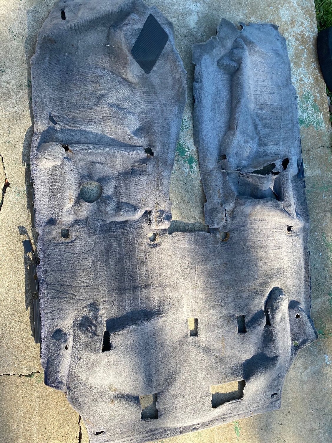

anytime i buy a used car, i take the carpet out and pressure wash it. I typically put a mix of Oxy-clean and dawn dish soap, let that sit for 1 hour, then pressure wash. The carpet will look and smell as close to new as possible. Just let it dry for 2-3 days before putting back in.
This before and after picture is from a beatup Landcruiser I bought this summer. I was amazed at how clean I was able to get the carpet, it almost looks and smells new
