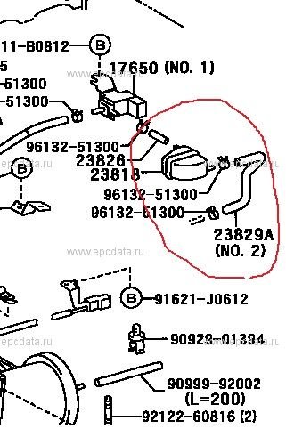

Recently had a used gearbox put in as the original was slipping.
long story short the new but used one is also slipping from 2nd to 3rd. (Same as previous but not anywhere near as bad and less worse when fully up to temp.
Gonna check fluids again Monday to be sure but could it be anything else? Just low fluid?
Noticed this hose open in the bay as well but surely not related?

Pretty much next to the battery tray
Metal pipe at the bottom and the loose end of the hose is going under the engine cover.

https://www.japan-parts.eu/lexus/eu/...ol-engine-fuel
update the data categories (year, frame code, etc)
Look at tool/engine/fuel tab, sub category Ventilation Hose, or Vacuum Piping

Yeah I did try looking through amayama etc. But couldn't see it. Probably part of some weird sub section.

i took the engine cover off this morning and it goes to a trapezoid shaped air vacuum valve / probably part of the evap system reattached with a trusty zip tie.
