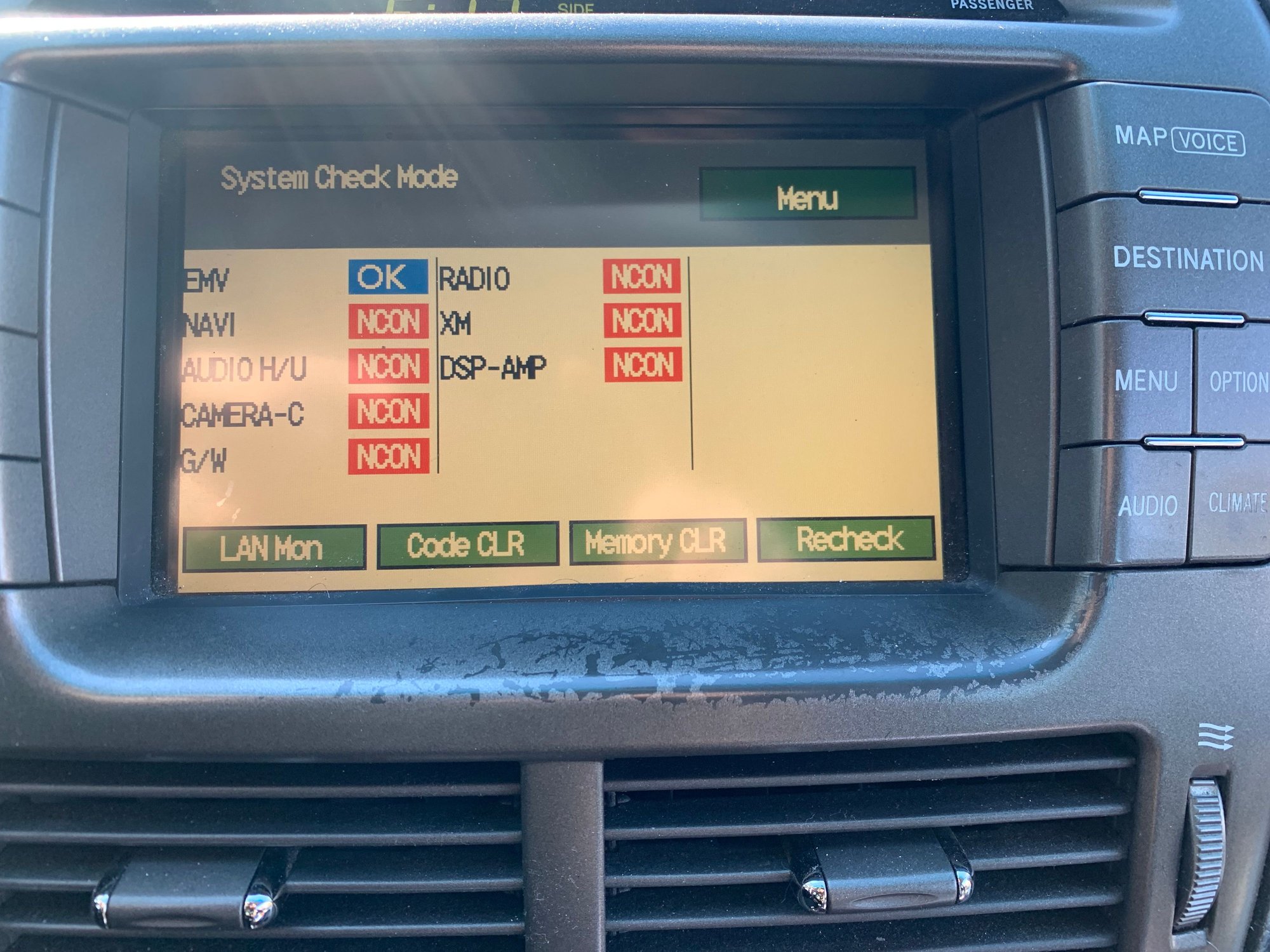

So recently we had a huge downfall in SoCal. Long story short I drove through what I though would be a normal puddle and it wasn’t. Now the issues I’m experiencing is intermittent starting issues (Sometimes the car will start no problem. Sometimes it takes several attempt to get the starter to kick.). Also have an intermittent issues with the stereo (Mark Levinson), Climate Control and rear view camera not working. I changed all fuses and even the starter relay. Inspected all the fuse boxes and they look dry. After reading a few threads I see people have recommended changing the luggage compartment fuse box. Also saw someone recommend changing the AC amplifier (I get a check AC connection message when the climate control refuses to work). And the head unit for the stereo will power on but no sound. Other than that, everything else works. Where should I start? Is there an ignition relay under the fuse box in the engine bay? From diagrams I looked at, it seems there is two relays located under one of the fuse boxes. Also did the secret diagnostic manu on the nav screen during one of the times the climate control/stereo and reverse camera were not functions and this is what came up

I’ll try the battery disconnect tomorrow. That and a few relays are the only things I haven’t tried yet. I’m wondering if anyone has a description of what each relay does. I know I’m the underside of a fuse box or two there is a relay for Ign and Acc. Just wondering exactly what they are relevant to.

So I did the system hard reset. Everything worked for a day. Then after I left work it went out again. Today after I left my day job it all came back on while driving. Pretty sure I might have to replace the rear luggage compartment fuse box.
