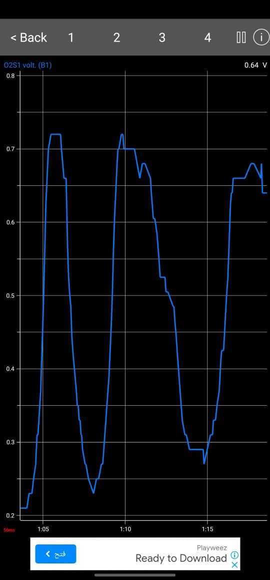

I decided to check the data with TechStream again and I noticed B1S1 is having average 0.68v compared to B2S1 is having 0.72v which I think is normal during idle yet upon giving a rev I noticed B1S1 go upto 0.98v and drop to somewhere around 0.23v whereas B2S1 drop to 0.02v - I think 0.02v is too low? But no-fault code shown for Bank 2 Sensor 1? Now I am seriously confused what's going on! I checked the wiring harness of B1S1, and everything seems fine and connected. I am completely lost. Ever since I removed O2 B1S1 and sprayed WD-40 I am now being haunted by the code "P0031 - O2 Sensor 1 Bank 1 - Low Circuit" and even after replacing the O2 B1S1 itself with OEM It won't go away. It's just made me waste my money! I am not sure, even the old O2 Sensor might be good. Live data during revs for B1S1 looks like this:
Upon live data - The sensor does work fine? Please advise what are the possible options. I am sure that WD-40 can't have done much damage! Considering I replaced the sensor already! Should I replace B2S1 also? Even though I don't have any fault code for that. How do I get rid of P0031 and this random misfire that's going on especially when engine is warm and in idle. I don't even know if any component is being wear and tear due to this misfire. My RPM's normal idling range is around 200-400 - Mostly drops to 200ish when I put gear to park and turn off A/C/headlights (Seems like common issue with LS430 - I even cleaned TB/MAF - Won't fix).
