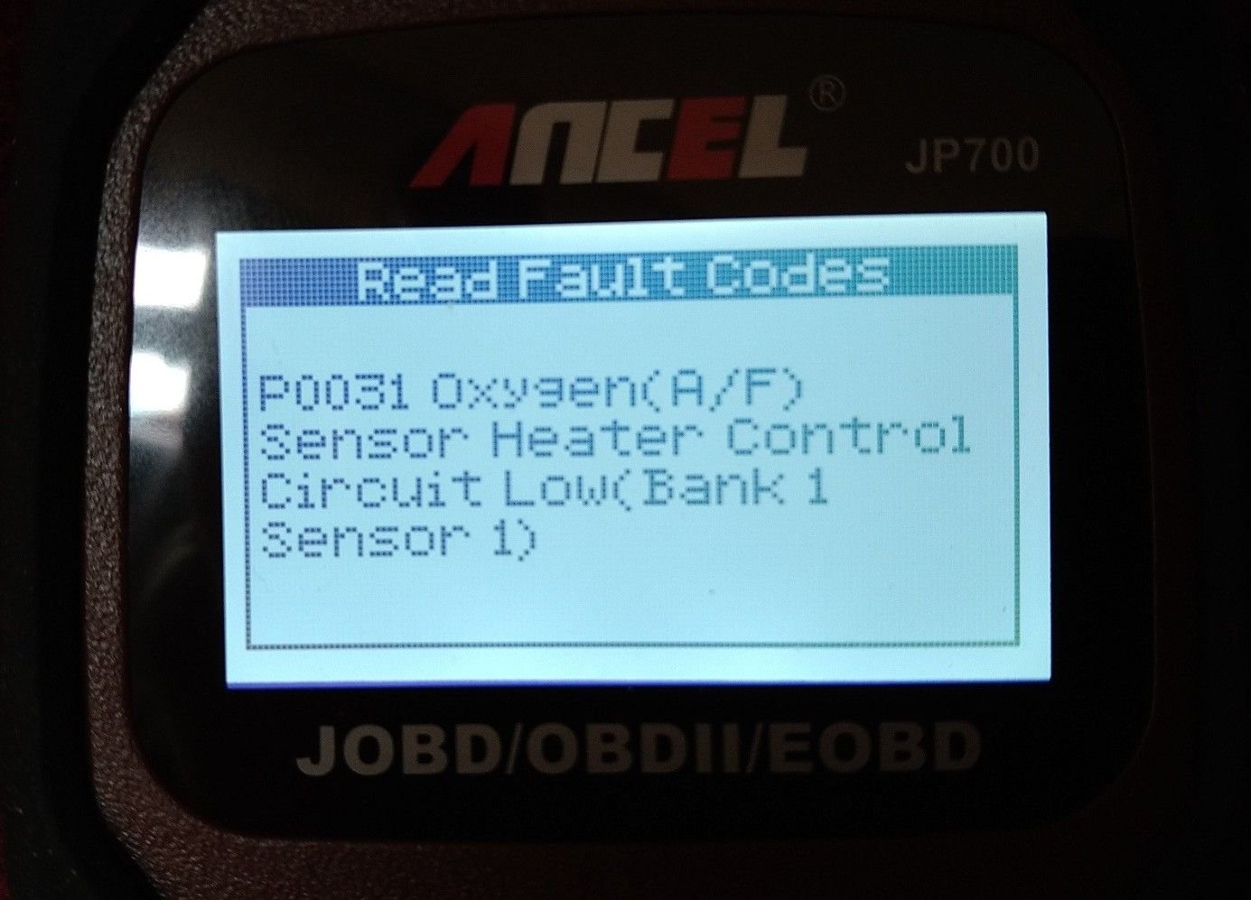

Hi All,
Today, whilst driving on a particularly rough stretch of road (which is typical of these parts as BigBoomer will attest to), I had three warnings come up simulataneously - Check VSC, 'Check Engine' and TRC OFF.
I checked - and cleared - the error code which was P0031 (see picture). And on restarting the car, the warning lights did not return. (So on that basis the error code pertaining to the O2 sensor was not just a red herring!)
Now. Please could somebody explain to me, like I'm five, how an O2 sensor anomaly could have anything to do with VSC or traction control? (I mean, I get that driving on bad pavement could knock something out of whack. But an O2 sensor?) More bizarrely, I've seen posts that talk of a leaky fuel filler cap causing the same thing!
Cheers guys...

From my brief experience and readings, it seems Check VSC is added to every Check Engine code. For example: O2 sensor, EVAP system, or VVTi Solenoid issues.
If there is no code, VSC OFF is indicated due to bad fuel cap or when yaw calibration is required, and maybe other issues. It seems yaw calibration is affected when we clear engine code(s) using OBD-II scanners.
I assume VSC OFF and TRAC OFF indicators are related.
I hope mechanics and other more experienced DIY owners will educate us.

To the OP. What year is your LS430.? Yes it’s true that the all those lights you are referring to will illuminate when there is a trouble code. Clearing the DTC will not necessarily clear the lights until the problem is fixed. . Sometimes they still don’t go out even when issue is repaired In that case and only if u have an 01/03 the paper clip fix will work. Won’t work with 04-06. Look up paper clip on the LS 430 forum for details. Good luck

Thanks - I saw that fix, but having cleared it with the scanner, it appears good for the moment.
It's an '04, by the way. The only other time I had a warning was on the drive home from having bought the car - when I got the dreaded 'Low Tire' alert. (Pressures were OK of course, I reset it under the dash and it hasn't occurred since.)
Just seemed like more than a coincidence that it happened when driving on a road with a lot of patchwork.

Potholes, yup we have them everywhere, lots of them, big ones, small ones, everything from minor cracks to axle-breakers. It comes from 13 years of "Austerity" which is Tory for "we stole that money".
Chances are that the jolting from the potholes caused one of the connections on Bank1 Sensor1 O2 sensor to momentarily go high resistance so the voltage at the heater coil is too low.
That is enough to trigger the code. Since it went away with the reset it is working normally now.
However, that doesn't mean it won't come back, and it may be a first indication of a failing O2 sensor or a broken wire/connector.
As for the Check VSC & Trac Off, I had the same when my Bank2 Sensor 1 heater failed. What is really insane is that these heaters are ONLY for when the engine is cold. Once up to temperature the engine keeps the sensor hot enough.
The emissions that a failed O2 sensor heater can cause is limited to a minute or so after a cold start, but it can cause clogging/fouling of the CAT, so best to swap it out as soon as possible.
I have absolutely no idea why the Traction control or VSC are disabled as they are safety systems and should be able to cope with a failed emissions/engine tuning sensor.
Disabling those in any situation that does not 100% require it is dangerous and stupid.

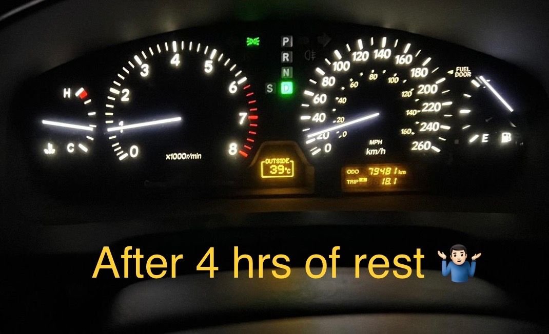

Default Mine got exactly the same errors, I left the car for 4 hrs then errors were just gone
Originally Posted by VolumeToo
Hi All,
Cheers guys...
Mine LS430/2006 got exactly the same errors today. I left the car off for 4 hrs then errors were just gone!
Can anyone shed some lights on this please?
