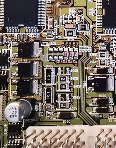

I'd rather think it's caused by the ECU. It is the often case that the heat cycle damages the soldering points. If I were you, I'd simply check the inside of the ECU using a good magnifier and carefully see soldering points where bigger sized resistors are soldered. It is the often case that the heat cycle damages soldering points in case of a JDM Celsior. May be the same with a LS430.
Folloing resistors should be checked. R216,R217,R235,R236,R239,R241,R304,R305,R306,R307,R328,R329,R393,R738,R740,R752,R767,R769,R910,R912,R918,R919,R920,R921.
Especially resistors at this area.

Thanks for the reply. Where do I locate the ECU?
