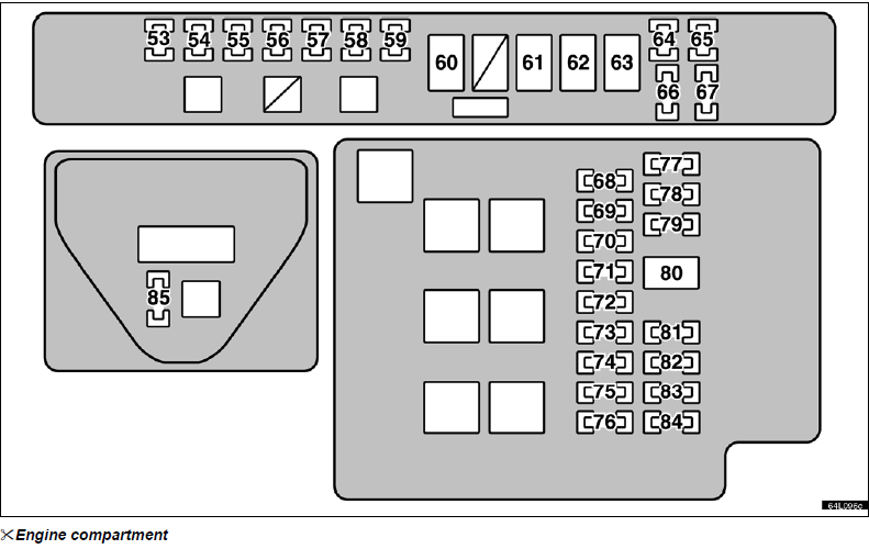

  1. how to check the fuses on the fans since I am not sure where I put my owner's manual.
  2. "Will both fans turn on when AC is on?" or fans only turn on once engine passed certain temperature.
  3. What other things I can check other than coolant level?.
  4. FYI - my car was at Lexus for timing belt last week and I have been driving it everyday without issue until today. I don't think it has anything to do with water pump/ thermostat

Check the oil level, too. After the TB/WP job, accessory (serpentine) belt could also be suspect (guessing).
From the 2002 Owner's Manual
Fuse #74 (7.5amp): Electric cooling fan, Headlight cleaner, Charging system, Starting system, Rear window defogger
Last edited by RideSmooth; May 26, 2023 at 06:30 PM. Reason: Added year 2002 and (guessing)
