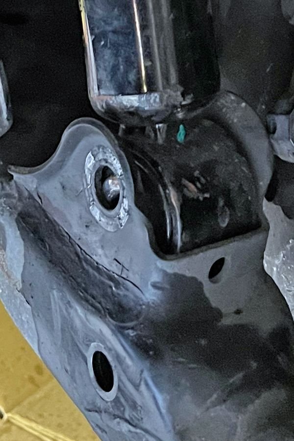

Today I went to re-torque the front bushing bolts on my lower control arms and noticed that the nut on the right side is just spinning on the bolt and not going up or down the bolt. It's as if the nut is stripped on the bolt and it just spins. I can pick up a new bolt/nut from my Lexus dealer but any ideas on how to get the nut off?
The reason I'm re-torquing these bolts is because the guy at the alignment shop couldn't tell me what he torqued the bolts to...he said he put them on "tight". Neither bolt was torqued to 127lb.

Yes, the nut pictured is the front nut. The nut just spins and doesn't go up or down the bolt. I've never seen that before. The bolt is not moving and the nut can be turned in either direction but does not advance either way on the bolt. I'm getting the idea that this nut is a one time use part and I should have replaced it? Especially when torquing to 127lb?

To be clear, my question is not how to torque the but on the bolt but rather the nut has failed.
How to I remove a nut that is just spinning on a bolt?

Update: I got the nut off. Surprisingly there aren't really any tutorials for this sort of problem online. I used a dremel to cut the nut lengthwise just enough for the threads to catch and allow me to screw the nut off. I stopped my my alignment shop this morning and they quoted 1-2 hours of labor to cut it off, depending on what kind of angle they had and if they had to remove parts to access the nut. Glad I saved myself that labor.

Not sure, the bolt threads were thrashed. Likely from destroying the nut and backing it out. I spent $50 in parts between the bolt, nut and camber washer. I was able to line the washer back up so no need to have it realigned.
