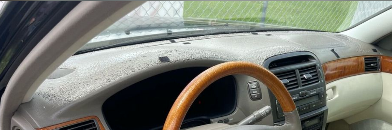

So I have a 2008 LS but am looking at a 2002 on FB Marketplace. I'm looking at the pictures of the dash and I have no idea what it is other than a car version of measles. Thanks for any sage advice.
. Can any of you tell me what this is?

The dash melted, common for 2000s cars, the 4ls has it too and pretty much all infiniti fx

Yes that does happen to some dashboards. Based on what I read, it happens when you clean your dashboard with some sort of harsh product along with beating sunlight - it creates bubbling. Apart from replacing the dashboard, there’s not much you can do.

I'm used to the dash issue for because my 2008 LS460 had it and I was lucky enough to get it fixed under the warranty. I had no idea the issue was also affecting the LS430. Thanks.

I looked at a few Lexus parts dealers and there seems to be no NOS replacements. Do you have any thoughts on an alternate source? TYIA

I've seen people sand it down then repaint, or I guess you can get an upholstery shop to recover the dash? Leather, suede?
