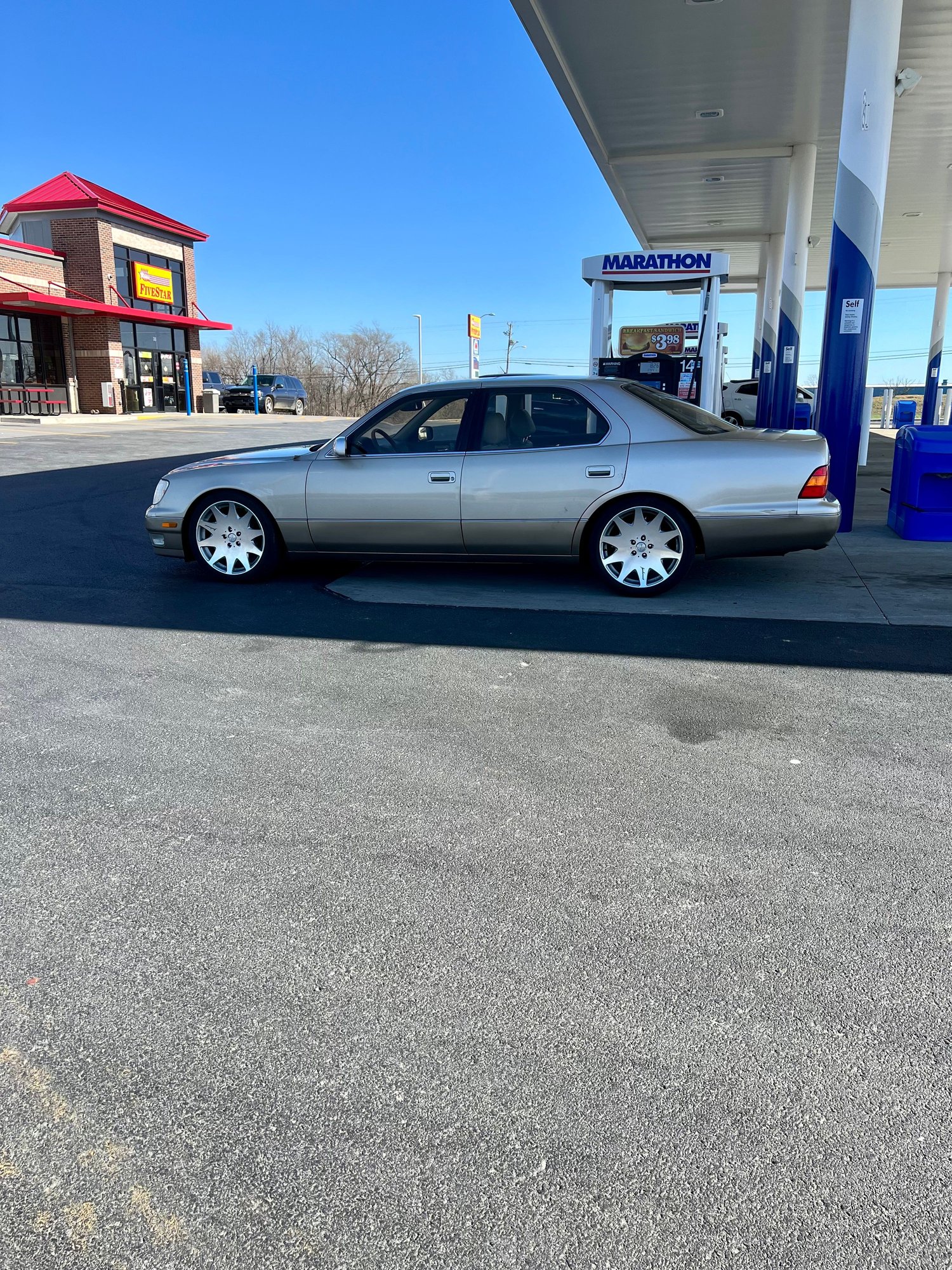

Shocks……these things are worn out. As this car will see much less duty now, and be handed to my youngest kid, he’d like it lowered just a bit. We put 19 inch wheels on it last year and it looks nice but it could use a very minor drop, like an inch or so.
Recommendations for decent coil overs that will give us a minor drop, don’t need top shelf stuff but want something decent as my kid will be driving it.
Reply 0
Feb 19, 2023 | 04:34 PM
Finally got coilovers put on the kids car. The car is much more planted now.
