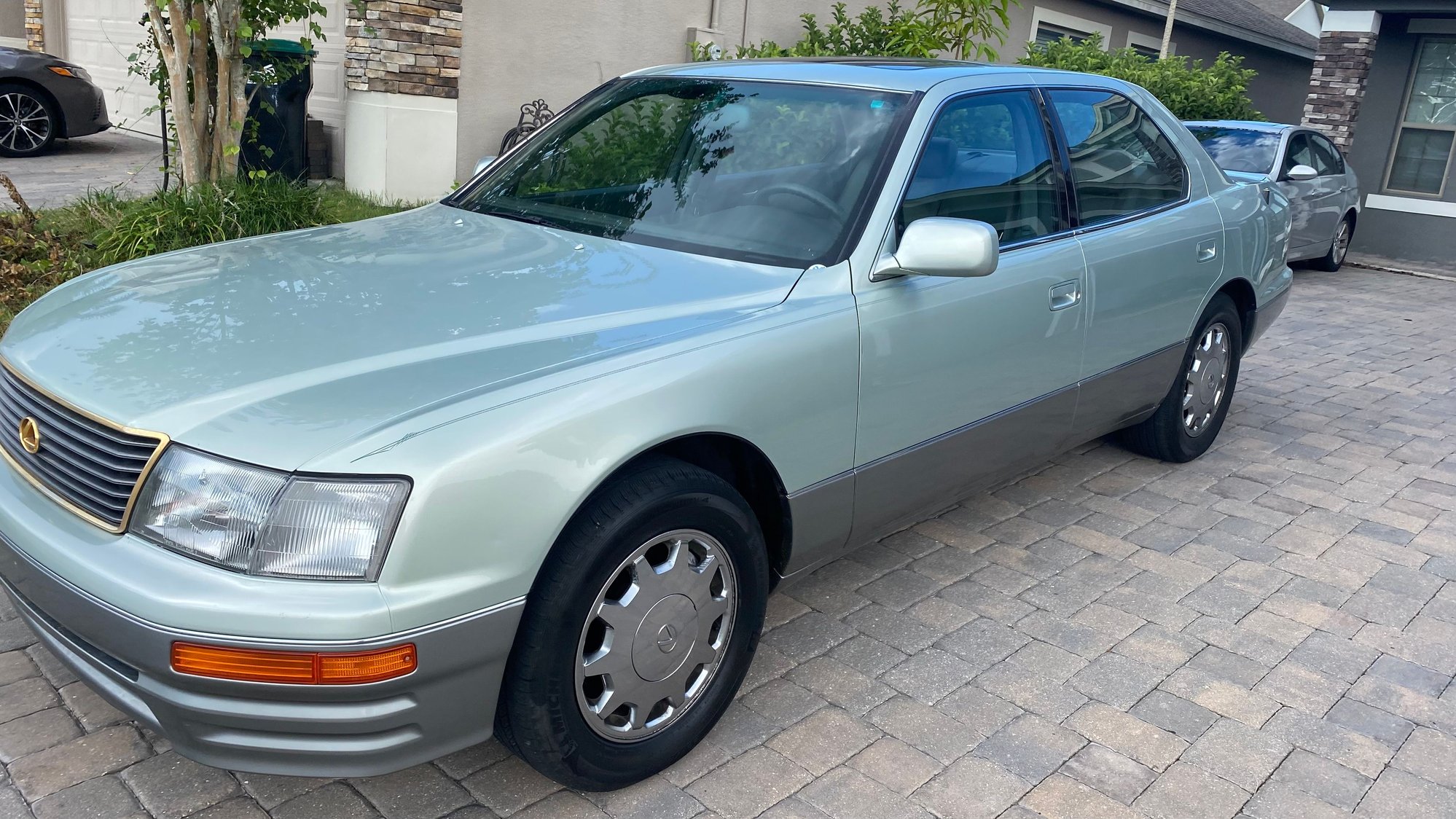

Here she is for those who’d want to see, 86k mi UCF21 (first pic most recent)
