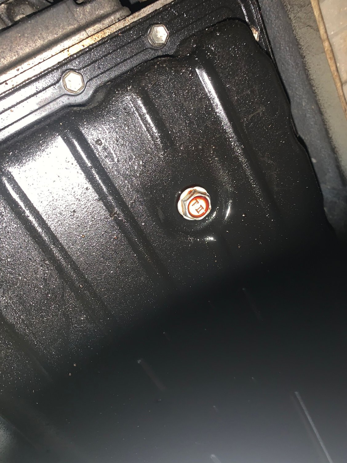

So I think I found the cause for the drop in my power steering fluid. Can anyone tell me what this plug thats leaking atf fluid on the ground is?

ATF exists in two places... Power steering and transmission. As far as I'm aware, no part of the power steering system goes all the way back to where the transmission is. So if you're leaking ATF.... it's from the transmission. That's the lower drain plug for it right?
Could be rear-main seal or some other part of the transmission that's leaking. Impossible to tell without better pictures. You need to get the car up on a lift.

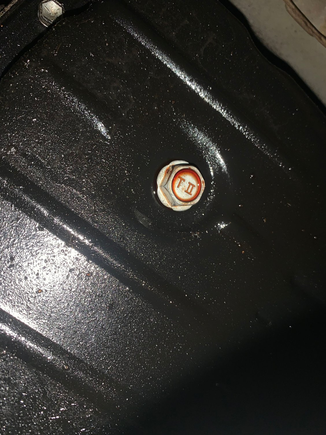

Here are some better photos of it. I tried tightening it to see if it was loose but it wouldnt tighten any further and I didnt wanna strip the bolt. Do you think I need a new plug or just a seal or both?

The whole pan looks wet to me, but I can't tell if it's fresh or old. Get a clean towel and wipe it and see if it's yellow (engine oil) or red (transmission fluid) in color. The plug could be leaking, meaning it's the crush washer between it and the pan potentially, or it could be something else like the pan gasket.
You can also try to clean the area, drive for a bit (while monitoring your transmission fluid level of course) and then see if you can find where it's seeping from.

its red transmission fluid dripping from the plug I just cant figure out where to buy a new one and which fits this car

90341-10011
Should be available at any Toyota dealer- https://parts.righttoyota.com/oem-pa...igh-9034110011
It's a metal crush washer which rarely fails if it hasn't been disturbed. As CELSIOR mentioned it could be the pan gasket leaking. If the entire pan is wet it may only be noticeable around the silver drain plug as opposed to the darker pan. Repeating CELSIOR's advice- wipe it clean and see what happens. Maybe try to gently snug the pan bolts as well.

Grab a can of brake cleaner, clean that up start the car and watch. There is oil everywhere impossible to tell the source.

So I wiped all the areas of the pan surrounding the drain bolt and it was just older black gunk except for that main drain plug which was covered in newer wet red fluid so I’m like 99% sure thats where its coming from. Im gonna call up my local toyota dealer and see if they have any of those plugs I can pickup.

90341-10011 is just the crush washer not the plug itself.
