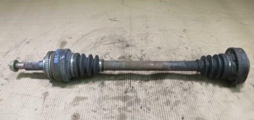

Is the clicking noise also tied to the speed you're traveling? Or is it associated with bumps and jumps in the road. CLLEXUSS posted below about it being the CV axle, and after doing some research, that is a good candidate for the clicking noise.

We, struts I don't think would have caused a groaning noise but I guess they probably needed to be replaced anyways. 280K miles is a lot. Sounds like a bearing, just a matter of which bearings. It's not an easy problem to track down sometimes because the noise emanation is deceptive as to where it's really coming from and it happens at speed. Sounds like to me it's u-joint issues, or wheel bearing, or possibly you rear differential. Maybe have a mechanic try to put it up in the air and run it. He may not be 100% certain either however like I say this kind of noise can be deceptive. Getting towards 300K miles bearings are starting to wear. Only way you are really going to know for sure is if you take the u-joints out and inspect them. I'd like to say it's probably just your u-joints with that clicking, that would be my guess, u-joints can make some wild noise when they go bad. Diff is probably okay, no play in wheel bearing probably okay. I'd tackle the u-joints, relatively inexpensive too. ( I am just theorizing on what I would do, not saying it is for sure your u-joints ) But the clicking and groaning is well within the range of how bad u-joints sound. Just be careful of a mechanic that tells you need an entire new rear end replaced, they don't always know for sure either, they'd rather replace everything and be done with it.

It's a cv axle to be more specific but operates similar to u joints, could be just one cv axle needs replacement, the one that gets used the most more likely lol

this is my guess, but I am just guessing.

Well there's quite a bit down there. I personally would tackle one thing at a time, what you are describing is most pertinent right now. Sometimes you do everything at once creates more possible variables. But to me everything you are describing is pointing to the drive axle cv shaft either right or left, or possibly both. (my guess) I am not sure which one is most common that goes first on these cars right side or left side, but generally one side gets favored more that the other I believe under normal driving conditions. But if you suspect one particular side and maybe can inspect for damage when you are under there and you want to save money just try replacing the side that seems to be affected and causing you the problems. (best to replace both sides if you can). The clicking groaning is very commonplace with a bad cv axle. You can't know for sure right now but I would just concentrate on that if it were me, and that's just me lol. Luckily they are fairly easy to pop in and out of there doesn't take long to replace them. You can kind of tell if a cv axle is bad once you get it out of there if you know what to look for, or you can take them down to a local shop and ask a mechanic to inspect your cv axles after you get them out of there, I'm sure he'll evaluate them for free for you if you are not sure, and he'll tell you the bad one, or maybe both are bad it's possible. But yes to not unnecessarily spend more money, have your axles inspected by a mechanic before you buy replacement cv shafts after you get them out.
