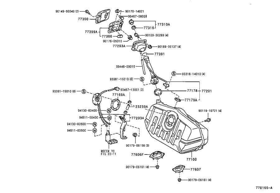

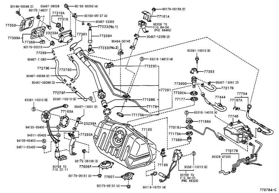

Fuel lines and charcoal canister.
1998-1999 fuel tank
2000 fuel tank and charcoal cannister
