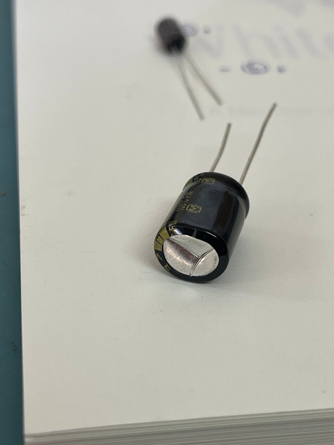

My caps finally arrived and my 220uf got smashed in transit. I had the ECU apart and everything ready before I noticed. Hopefully shipping doesn’t take as long this time. I should have ordered multiple 🤦‍♂️

Got all the parts and the time to fix the ECU last week. Once the caps were replaced it felt like a completely different car lol. Throttle response is a ton better and the transmission shifts like it should. The rpm’s don’t have a mind of their own and I haven’t had any of the electronics act haunted.
