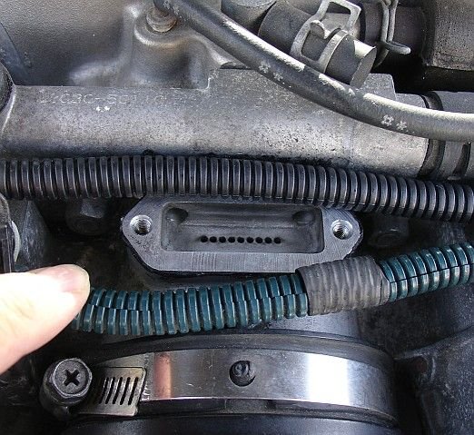

Originally Posted by Luux
I also have the problem when turning into a corner, and then hitting the throttle, nothing happens until 1500rpm.
That symptom is often caused by the clogged air mix path. You definitely need to clean the throttle body as well as the air mix path which is consisting of 9 small halls and 2 larger halls as is shown below.
