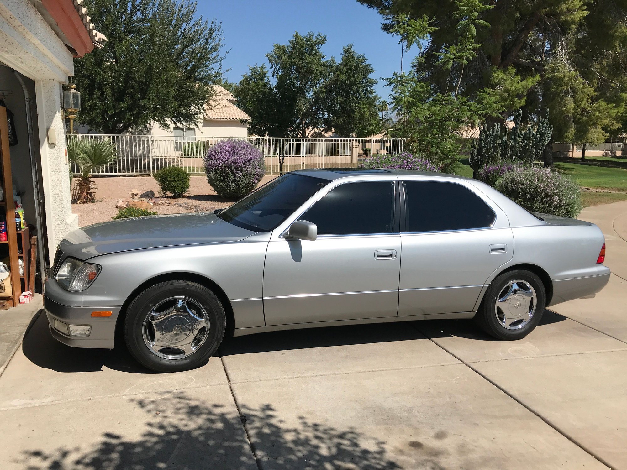

I haven't posted on CL in ages let alone a forum environment. But i'm here to share something i picked up for my 98.
December 2020 i happened to be browsing Yahoo Japan out of boredom and i came across something interesting. Interesting to the point that i even googled this and nothing popped up. its a Bilstein B12 suspension package designed for the UCF20.
I figured with it being in the middle of a pandemic and I not having the most experience shipping parts from Japan, it would be tough to purchase these. but after waiting for the January Stimmy to hit and finding a company that confirmed they could get them to me quickly (GETJPN) I got them ordered of April 2020 and they went out in their July Container.
With delays at the port in Long beach, they came in the end of august and i got these delivered last week 9/7 which i'll say the wait has been taxing lmao. My first call was to Bilstein themselves to get any kind of info on this kit. I have to thank them alot for probably some of the best customer service i've ever experienced. They managed to get me a Kit part number (F4-S00-8062-M0), a spring rate which seems soft but i think its stiffer then they advertise, and a pretty nice drop. they couldnt say exactly how much it would lower the car but after the install I quickly realized how badass this kit actually is.
difference in the rear assembly
installed
This by a long shot is the lowest car i've owned. but it's dampened perfectly. it doesn't bounce or hop like most cars on lowering springs at this height would. And it's really comfortable. Oh before i forget to mention, Bilstein never sold this kit stateside so this to my knowledge, is the only one in the country.

Sep 14, 2021 | 01:08 PM
This is what my 99’ looks like on Bilstein HD shocks on the lower perch, I think it gives a 0.6” drop, perfect height for me and it being my daily. I would say your setup dropped about 1.5”

Sep 14, 2021 | 01:32 PM
Quote: This is what my 99’ looks like on Bilstein HD shocks on the lower perch, I think it gives a 0.6” drop, perfect height for me and it being my daily. I would say your setup dropped about 1.5”
also you might want to change your title otherwise no one will benefit from this information in the future, call it Bilstein suspension kit or something along those lines.
Thats still like 3 finger gap on the stock 16's if i had to guess and assuming the springs arent sagging? Im currently at barely a finger gap all around on 17's. I wanna say 2-3 inches at least. these cars ride so high stock its insane.

Considering how low the car is vs the price i paid to not only import, but to ship from california, i cant complain. i'm into this entire thing for 500 bucks to my door.

Sep 16, 2021 | 08:55 PM
I have about 130K on the Bilsteins. The OEM KYB's were gone before 60K so that's pretty bad. The drop up front is about 3" so roughly there is about 2.5" of suspension travel. The backs being higher are in better shape. I have no hesitation with another set of Bilsteins on this. FIL's '14 stock Accord LE rides stiffer than the LS and it has 60 series rubber. I've been in enough cars at stock height that I feel rider stiffer than our lowered LS. That's shocking. (har-har)
