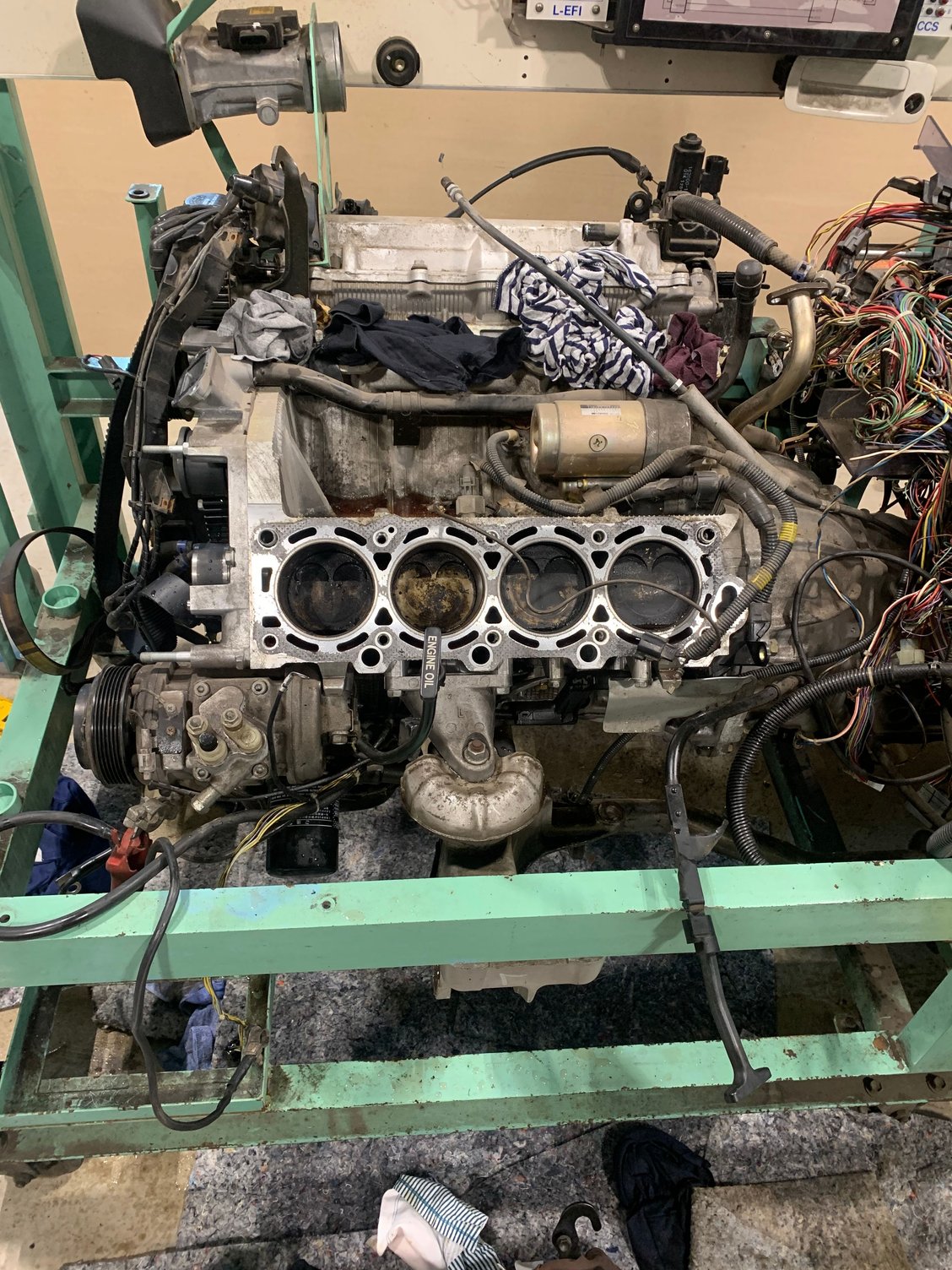

I recently picked up a lexus electrical test motor. this motor came from a college and was used to diagnosis different issue's with sensor's or other components of a ls400.
the odometer showed 327 miles on the motor. internals are extremely clean with everything looking new. was told it needed a fuel pump and would run.

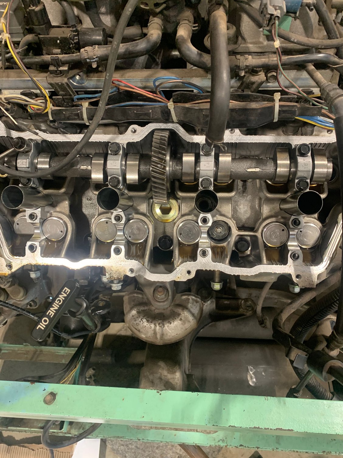

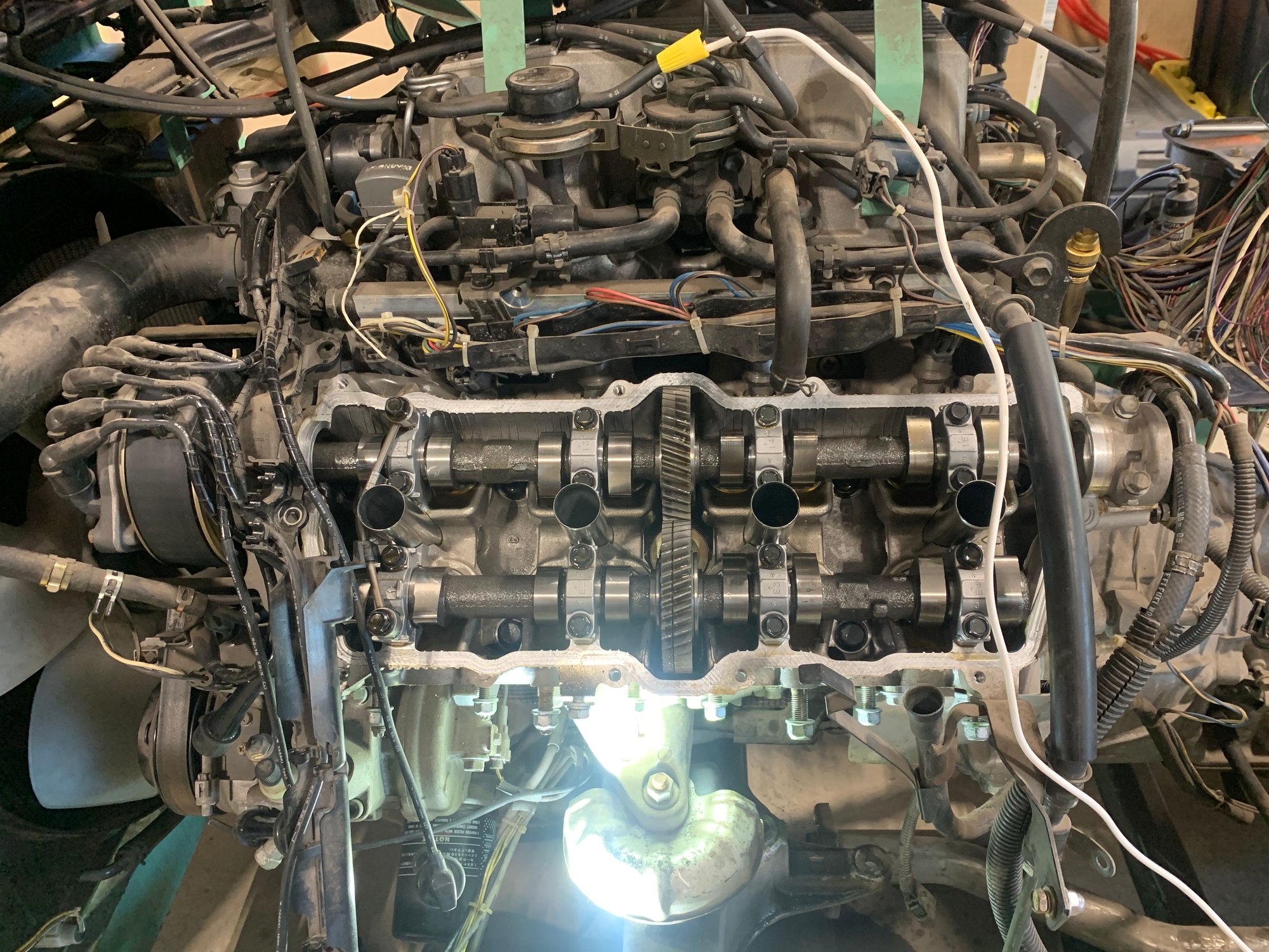

installed fuel pump from a ra65 Celica i had here and fired it up. it started but noticed it wasn't running on all cylinder. started the diagnosis and eventually found that two exhaust valves were completely stuck open.
so now I currently have the motor torn apart and the heads are off to the machine shop to have those valves worked. i have a spare motor and can get my hands on two others for around $500. this motor is spotless and the cleanest internal motor i have ever seen so I am absolutely torn between continuing with this motor or sending it to the scrap yard and starting with another.

thankfully the 1st gen 1uz were non-interference or the stuck valves would have said hello to the pistons!
the question is why the valves stuck! in all my years i've never heard of that happening so perhaps the motor, albeit low miles, saw high RPMs? what oil type was used on it?
with it being on a cart is there any other cooling mods other than the factory fan and radiator setup? these engines are finicky if you don't properly bleed the air out of the coolant to see overheating. pretty cool rig!
Reply 1
Jul 14, 2021 | 09:46 AM
The engine shows no sign of overheating but it is a possibility I assume … the motor was used for replicating faults and having students work on it until they figure out what caused the issue. I believe them doing this along with it not being revved very high tells me it built up carbon and never had the chance to blow it out… then the motor sat for a decade. There are stickers stating to never take it about 55mph etc and with a lack of load all its life this engine really hasn’t been used properly.
but we’ll see what the machine shop says about the heads… a couple light taps and the valves went back in, I talked to a couple others that have had a exhaust valve stick from the engine sticking but it’s only really 1 or 2 I’ve been told on a 1uz and I take that with a grain of salt.

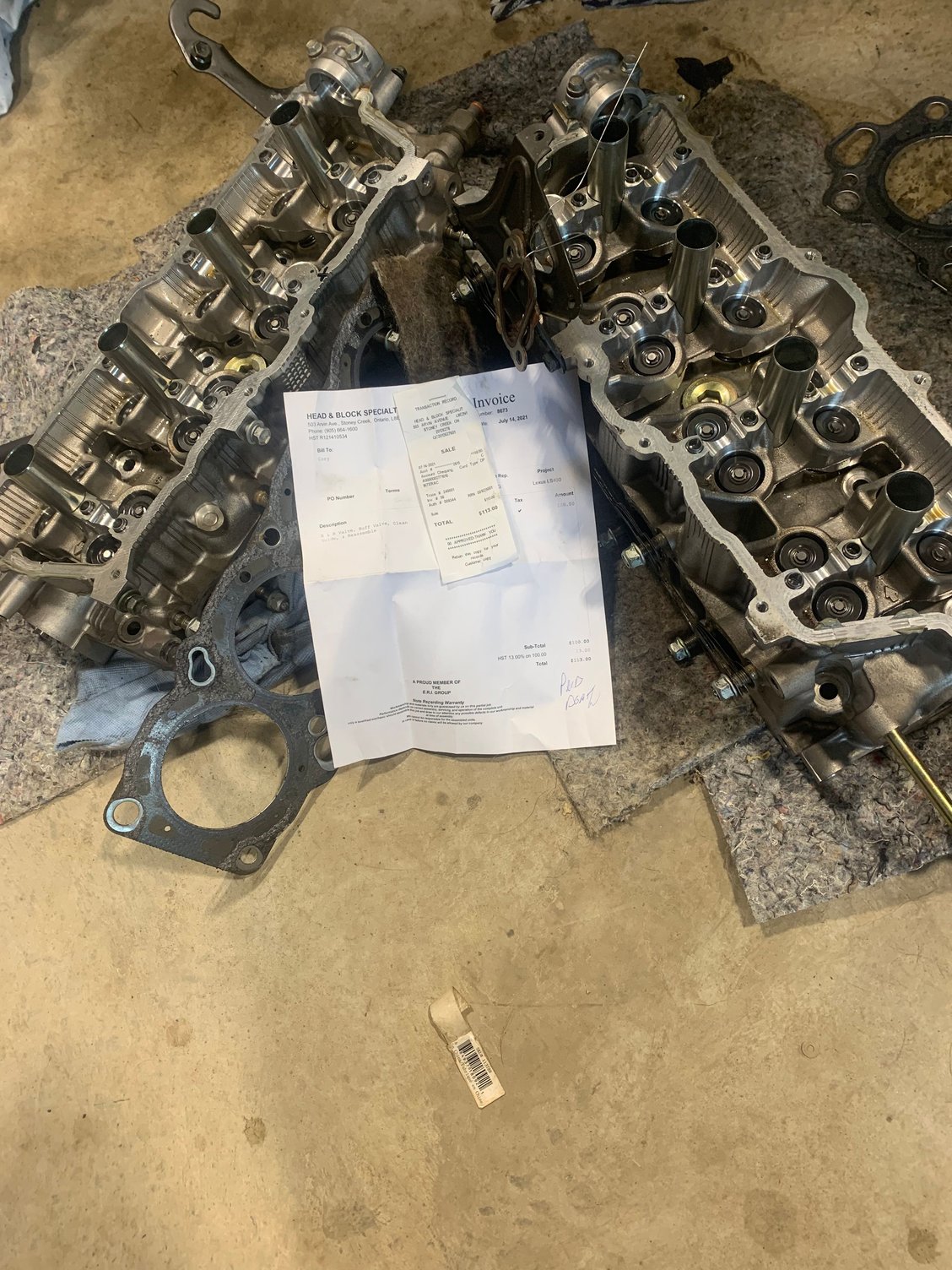

I also thought If heat was an issue you would see discoloration… as you can see from the picture of the heads compared to other pictures of 1uz heads .. these are very clean without any discoloration commonly found on them
but this is the first motor I’ve cracked open in a decade and before that it was only Nissan sr20’s so I honestly could be out to lunch
Reply 0
Jul 14, 2021 | 12:59 PM
Well, received a call from the machine shop that the heads were done, not bad for only dropping off 24hrs ago.
$113cad was the total, I was correct and it was literally carbon build up that caused the valve to stick.
