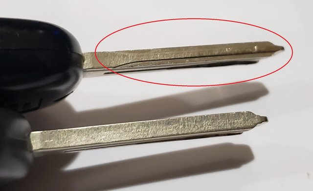

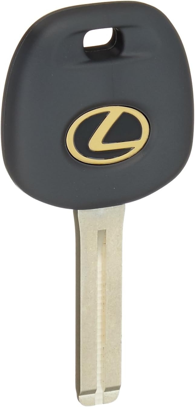

Sounds like you got the valet key with the car.
Looking at your profile, you have a 1999, so the Valet key looks like this:
The main difference from the master key is that the Valet key has no buttons and is greyer than the master, which is black.
You can see the difference in the second photo here, where this owner shows his 2001 ES keys:
https://www.clublexus.com/forums/es-...ml#post9795756
Note that the fob in the first picture matches the key for 1995-1997 UCF2x LS 400. In 1998, the buttons for the fob were combined with the master keys.
