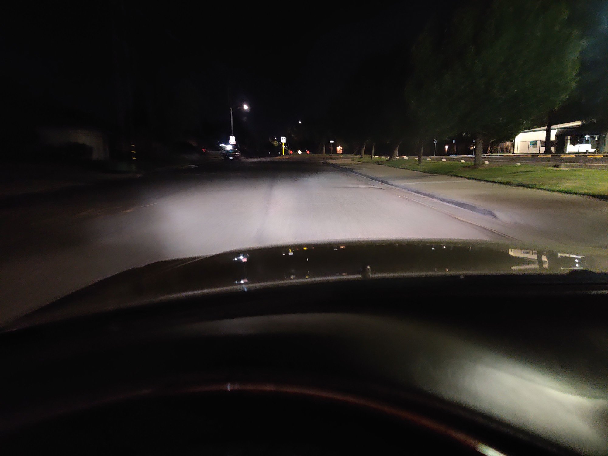

Found this
This is also how my lights look. I notice the daytime running lights do adjust. But not head lights.
https://www.clublexus.com/forums/is-...l#post10863578

So should I worry?
