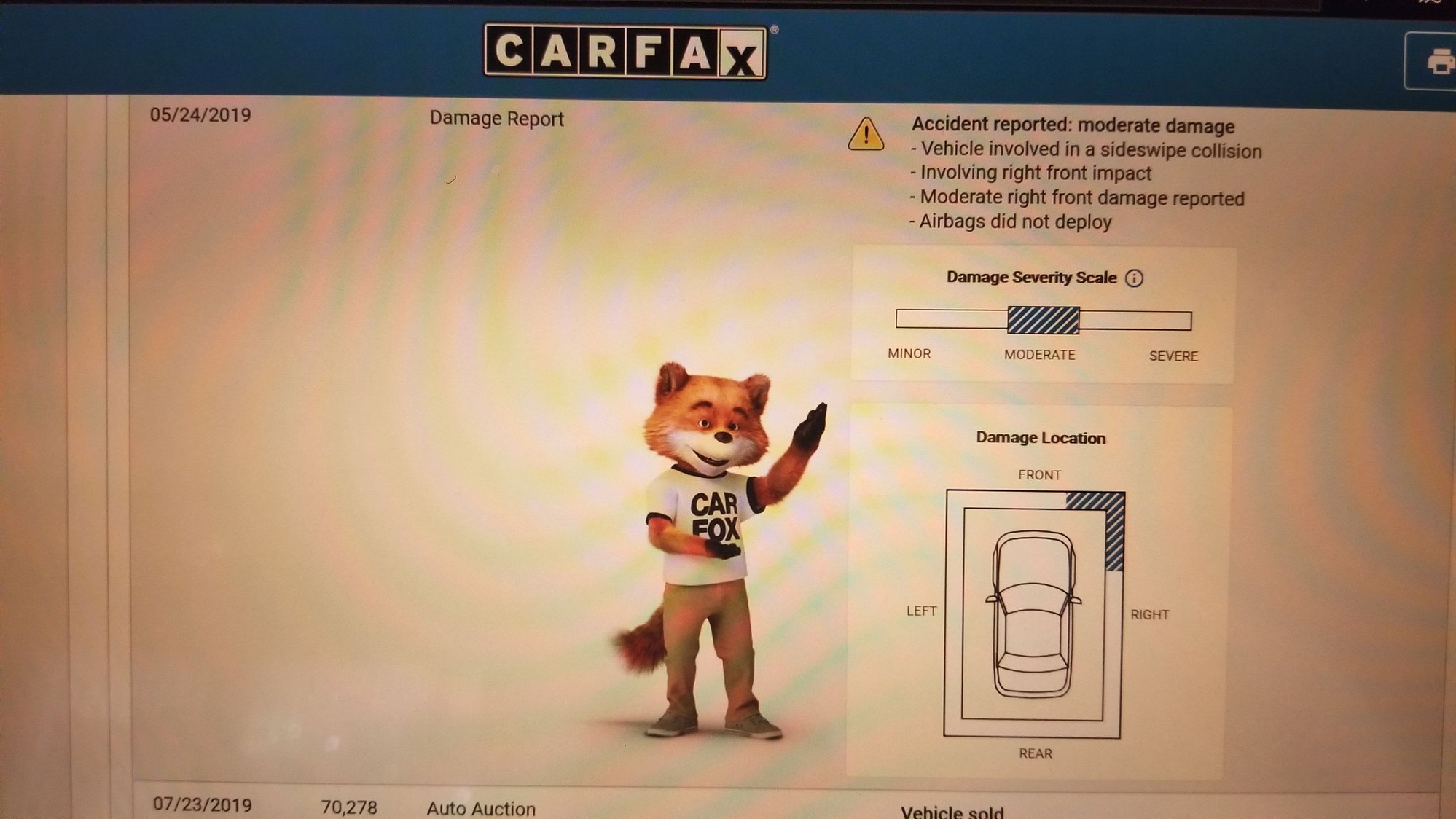

Timing belt and water pump done 1k miles ago in 2015. Car has 73k miles, old lady owned it for past 16 years. Been in an accident though, carfax says "moderate damage" from a side swipe. Can see the overspray on engine area when they painted it.

Is this worth walking away? They are asking $9,500.
I know the maintenance was fairly well documented, so felt comfortable with that. But they didn't provide carfax, I paid for it and this is what I find out. What a head killer....

Ok, we're walking away....thanks for the info guys. The accident seems to have been a bit more substantial than they tried to make it sound and is just not worth this price. It would have been without the accident though!
