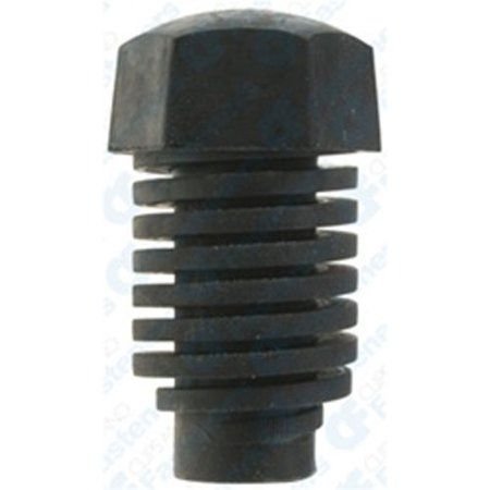

Turn the hood stop to take out the additional play, there is one on each side. These do tend to wear and become hard so replacing them is pretty reasonable. The one pictured is not the one for a Toyota but shows the spiral groove to make the adjustments.
Oh! Very cool. Thank you so much. I was looking at a new locking mechanism. This if it works I'm sure will be much cheaper than $60-$70! Woo hoo!!

The rubber part# is: 9054115014 ~ $6/each. This has multi-vehicle application even though it shows a 3-LS in the diagram.
It is #3 in this diagram:
https://www.trademotion.com/parts/20...iagram=8931075

These rubber cushions only adjust the vertical height of the front edges of the hood for panel alignment purposes. The hood really shouldn't move at all in the front, no matter what height these cushions are adjusted to.
Thank you I adjusted both of them to what seemed to be a similar amount and it held up even at xxx mph.
And of course no real movement when trying to move it with my hands.
