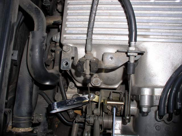

ok, so, as far as i know, typically, if TPS is bad it will hesitate when you try to rev it by hand as well
I'm still leaning towards something being wrong with the mechanical actuation of the throttle valve
how exactly did you check the throttle cable? did you check that it's connected securely to the gas pedal? did you physically pull on the cable from the throttle body side? can you have someone push the gas pedal and you watch the throttle body and see if the cable moves anything?
in this pic there are 2 cables, one of them is your cruise control the other one goes to the pedal. from the throttle side, pull on the exposed cable itself as far as you can upwards and see if the cable stops and retracts back. on the pedal side, check that it is secure (see red circle in the second pic)
if the cable checks out, have someone push the pedal (in PARK) and you watch for movement on the throttle body and then compare to revving it by hand, see if there are changes/differences in moving parts/patterns
here is a quick tutorial on TPS replacement and part# needed, but check the cable and throttle operation first, you need to absolutely rule out the mechanical mechanisms failure
