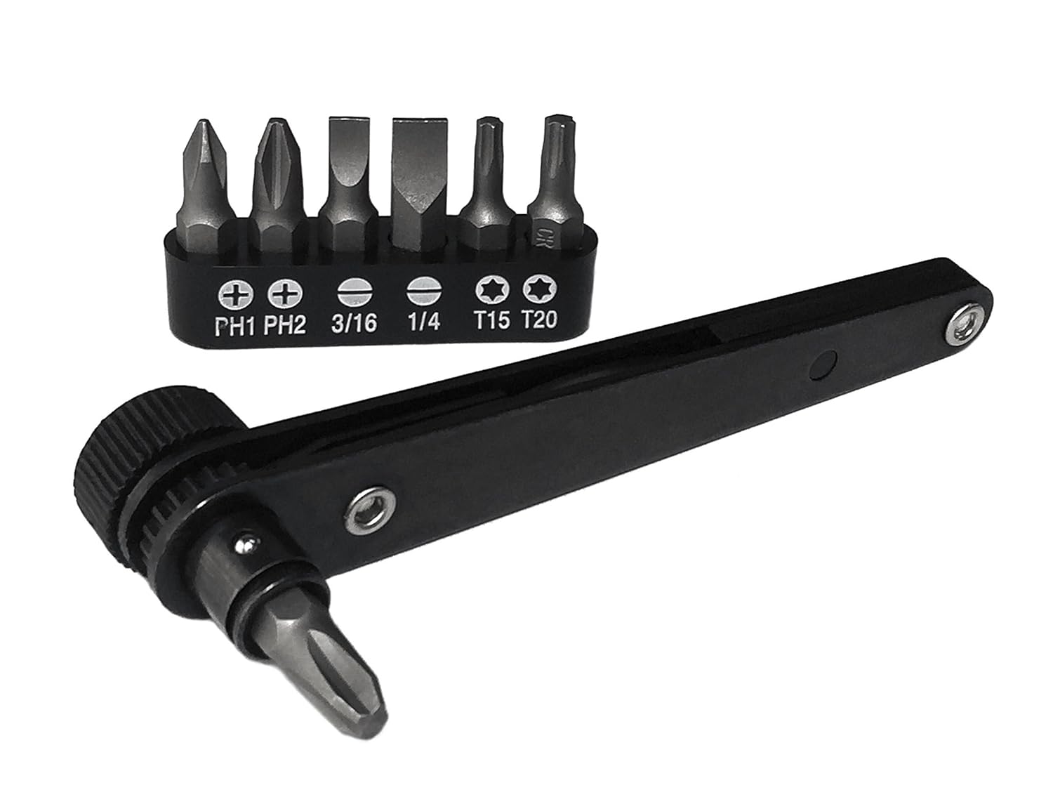

I mean, I guess the screw is accessible with enough effort. It's about 1, maybe 2 inches recessed and I can only pry the cover off a little bit. I'd have to use one of these things:
https://images-na.ssl-images-amazon....L._SL1500_.jpg
And there are lots of these screws, even on the side of the panel next to the windshield. It just seems like a total nightmare to take off. Which makes me think that I am missing something--it's a Toyota, after all--it should be easier to remove plastic trim panels.
