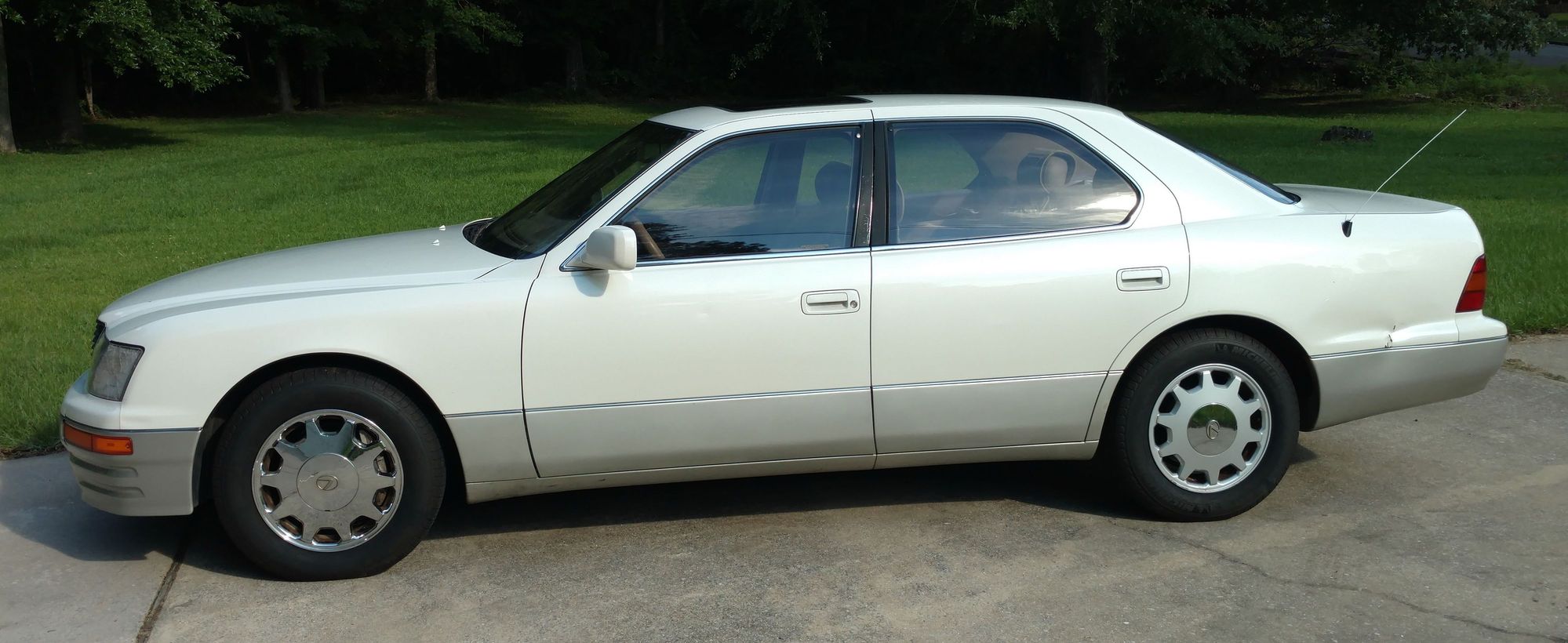

Thank you all for the help. Now that the hurricane has passed I can start working on the evil beast once again. I will try to keep up with what works and doesn't work so it can be shared with others. Thanks again!!!! I thought you might like to see the evil thing while it is still intact and I don't something really bad to her.!!! BTW She is for sale if anyone is interested. I am trying to get everything running right before I let her go but if anyone is interested like she it let me know. Only problems is this starter thing, it wants a catastrophic converter (that's my reference for a catalytic converter) it may be ok just needs tweaking and one bulb in the rear lights. otherwise she is good, new tires etc. In the meantime though I shall proceed in trying to fix the starter problem.
