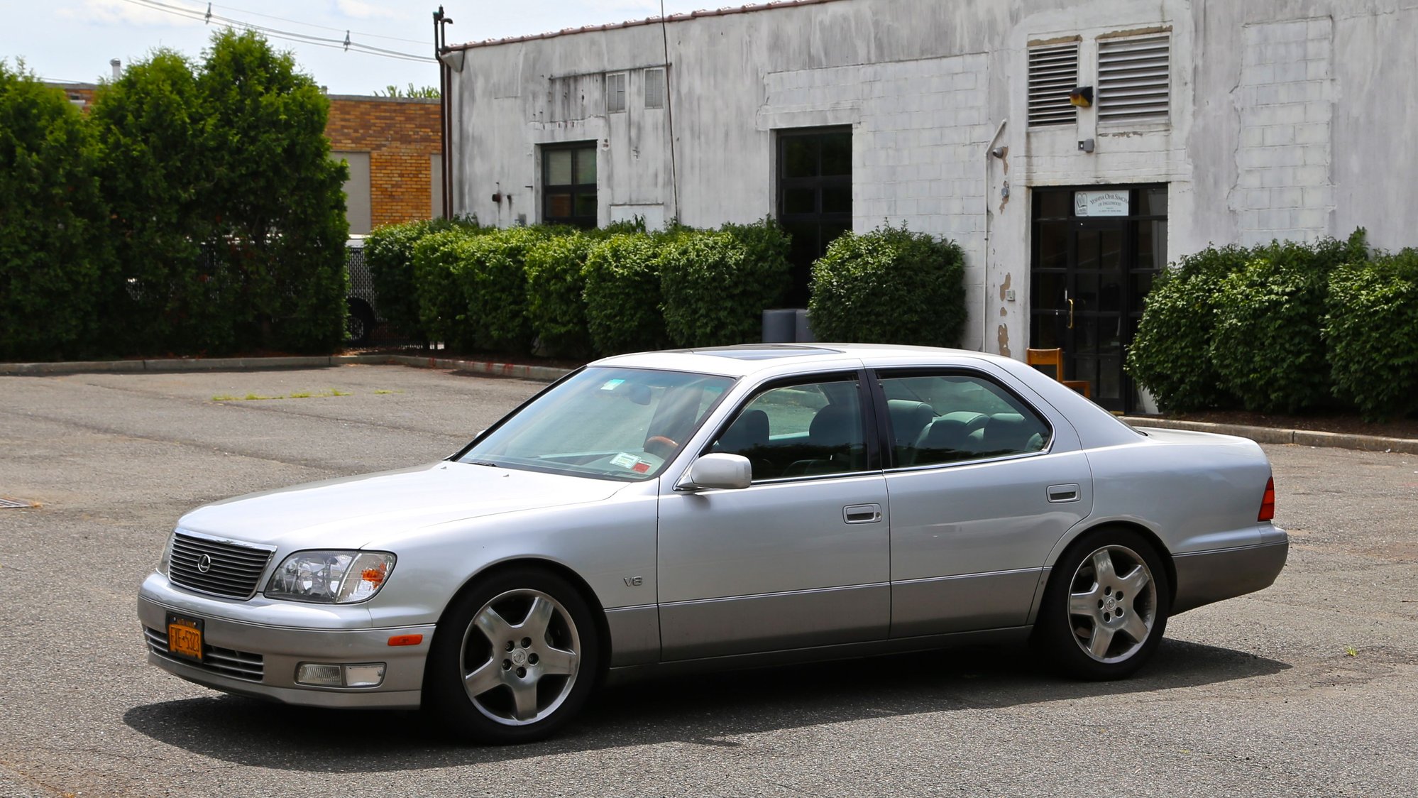

congrats on the japanese defection lol, i think you'll be quite happy with your LS (the proper version of LS that is). yeah the 430 wheels are tough to find, especially a full set. there were a few wheels that came with the 430 do you mean the 18" 5 spokes?
also the car is just a naturally soft and squishy car haha don't expect it to ever handle like a 540i or something. putting the 430 wheels does help ever so slightly but it's really a pretty negligible difference. new shocks will probably help a little but there's also various bushings which go bad over time (just happens to the rubber) known to cause certain handling side effects. the oem struts are made by KYB so buying the strut directly from them will save you some $$ rather than buying a "lexus" strut while maintaining a stock feel.

that's what i have at the moment, even with the 1" drop and spacers they fit just fine. i'd just get some lexus center caps to make it even more discrete lol... but the 245/45-18 is the same overall diameter as a 225/60-16 so it fits perfectly and the speedometer is unchanged

Your car looks perfect to me. I'm more of a factory look kind of guy and that looks great. Can you tell me what center caps you got, what color lugs, and where you bought the 1" spacers from?

aww thanks... i actually found my wheels on ebay, they were the ONLY set of legit, non replica wheels i could find anywhere and they came with the center caps. they don't look any different from the replicas but i'm vain and it was important to me that my wheels were embossed with the JWL stamp and that i be able to say "these were the ACTUAL wheels that were once on an LS 430" lol so i quickly bought them before someone else did
the spacers are H&R TRAK+ bought on amazon, and i kept the factory lug nuts. if you're into petty aesthetics like me, you might also have to end up lowering it an inch with H&R or tanabe springs because the stock ride height doesn't really "work" with the bigger 18s (to me at least) but other than that there's no reason
