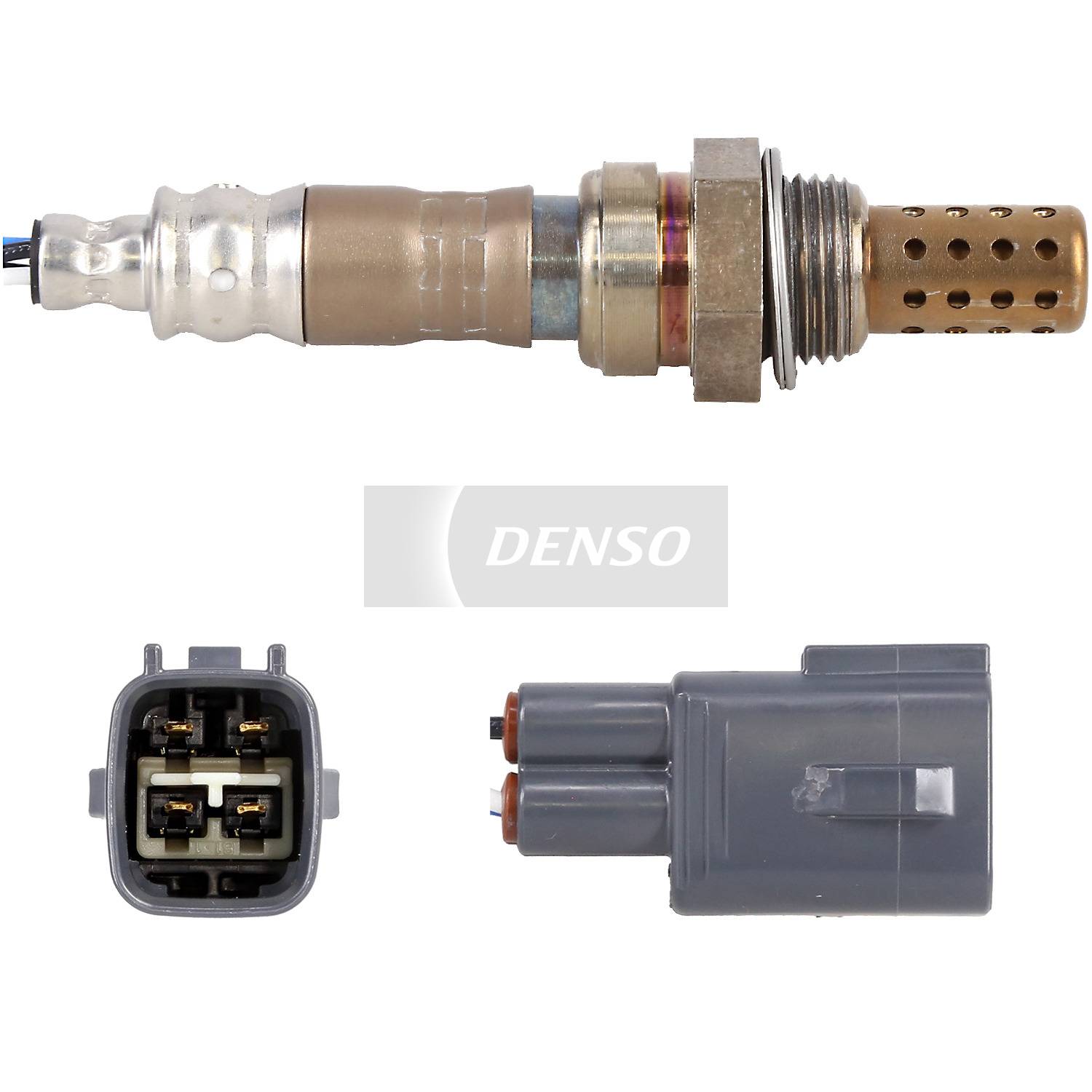

the codes are:
21 = Main oxygen sensor signal (on left bank)
28 = Main oxygen sensor signal (on right bank)
● these are both of your MAIN O2 sensors (i.e. the ones between catalytic converter and engine, also known as pre-cat)
● make sure your mechanic changes the correct pair - don't worry about the ones after the catalytic converter (known as post-cat or tattletale O2 sensors) unless you live in an area with emission standards.
● the Denso part number for both of them is 234-4169 - so you will need to order quantity two of these - best deal is at amazon
● normally I would advise more testing to make certain these have gone bad, but on a nearly 20 year old car, it's time to replace this most important of all sensors, this is the main sensor that affects how the car runs!
O2 sensors have it rough, they get hit with hot dirty exhaust their whole life and still are expected to report critical information! - I have included a photo of this exact Denso 234-4169 sensor.

Query: According to your Amazon link, it doesnt fit a 1996 LS400
Denso 234-4169 Oxygen Sensor : Amazon.com : Automotive Denso 234-4169 Oxygen Sensor : Amazon.com : Automotive
Also, seeing that I need Main O2 Sensor ( Left Bank) and Right O2 Sensor (Right Bank)
would it make a difference if I state that my car is RHD ? or would these said pre-cat sensors be the same on both RHD and LHD
