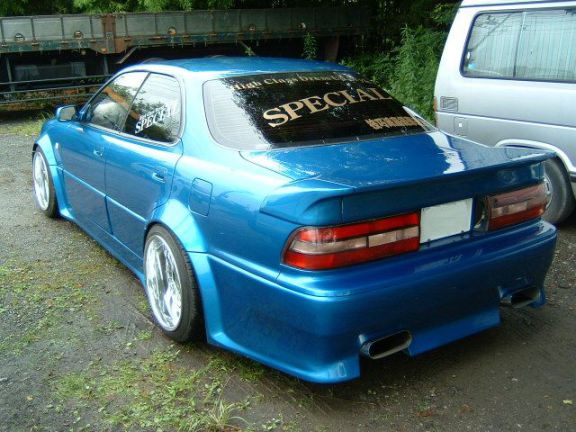

Has anyone used fender flairs to fit the super deep wheels on there LS? I have been wondering how this would look..
Old Jun 18, 2012 | 04:31 PM
KsportUSA's Avatar
KsportUSA
Posts: 110
From: Gilbert, AZ
Would look practically identical to this.
This is a Japanese model vehicle not sure what though.
