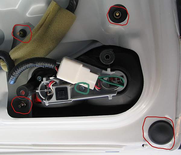

This one you'll have to remove the little retaining clips that fasten the liner to the trunk lid. The ones just behind the inner tails are only necessary. A small flat bladed screwdriver will pop them out easily. Don't be too agressive cause these little guys can go flying.
Lift the liner out of the way to expose this: (This is the driver/left side)
The smallest nut is an 8mm, the rest are 10mm. Remove the rubber plug on the outer corner and you'll have access to the nut.
Replacing the bulbs is much easier with the liner out of the way. To remove the bulb holder, you'll need a Philips screwdriver and where the green circle is, this is the one you'll un-screw.
Tail/stop light
7443
