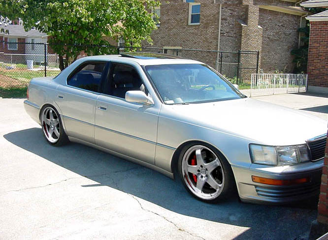

So what do you guys think? Should there be other upgrades higher up on my list? I think the leather will give the car a "new car" feel, and the suspension upgrades will significant improve the handling. I still can't decide wether to go with 18" or 19" wheels. Here's a picture of the one I'm looking at. How do you think this will look on my silver LS?
Here's what the wheel looks like:
I took a tire rack image of my car and did a quick photoshop with this wheel. My car is much brighter silver, and I plan to do black tints, not reflective.
Those are supposed to be 19". I think 20" wheels are just too big.
How will my handling change with these much larger wheels?
Like I said before, my goals are to just restore the car to give it a nicer feel both in terms of the interior as well as the way it handles. The wheels also serve to give it a nicer look, to kind of bring the excitement of having a new car. The tint will acent the look of the car as well as protect the new leather interior.
Any input will be greatly appreciated, especially other people's experiences. Thanks!

20's are just right IMO? The LS's are big cars and I have tried 18's and they just don't look right. The fender gap "looks" bigger because the face of the wheels got bigger with the 18's. It's more of an optical illusion but a hideous that I just can't live with. What people end up doing is dropping the car 2" + to compensate for the fender gap and I think It really cheapens the car and the ride.
It's suppose to be a luxury car and not meant to be a slammed wannabe race car, because it wil never be one. But in all fairness, there are aggressively lowered LS's out there that looks really really clean.
19's are a good compromise with a 1.5" drop. Eibach's are a good choice. Tanabe seems to be a little too low. And then there's H&R.
Just to give you an Idea, I tried >>> Ultra Wheels 20x8.5, Toyo Proxes 245/35/20, on my stock 97 shocks and springs. The result was a 3 finger gap in the front and 3.25 in the back. If I do decided to stay with that set-up, I will definitely lower the car with a 1" drop springs. Just with the upgraded wheels and tires, the car handled better already.
Good luck and try to learn from peoples mistakes. Unfortunately I did it the hard way. Personal trial and error.

I have a 95 LS and decided on H & R with a 1" drop. I will be replacing the struts with Bilstein next month. My 18's (8.5 on front and 9.5 on rear) roll smooth and there is less than a 1.5" fender gap .
The guys at MemoryFab are great. They helped me when I was trying to get the right wheel. I think Pagong has the right advice for you. I have some pics in my gallery if you want to see the gap, etc.

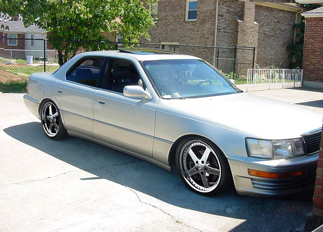

Take a look at some of these photoshops with some different wheels I've been considering after looking through MemoryFab and other places. I think the wheels will be the last thing I buy so I can save up more:
Wald Streifen 1PC:
Work Equpi's:
Work Euroline DH.. Very similar to Wald Duchatelet
Special thanks to Seize for those three photoshops, as well as absolut for doing some others!

I'm looking at a set of Wald Duchatelet 5Hx114.3 19x8 +43 from MemoryFab for a great deal. Plus they're located right next to me in UnionCity. Will those fit my 94 LS? The boly pattern is right.. I'm not sure about the offset etc. This setup isn't staggered. Should I try and wait for one?
A lot of companies have wheels that are VERY similar to the Duchatelet. SSR has the "Vienna" dish that looks almost the same, and they are also a quality company. Who came out with the original on this design? If I buy a set of SSR's, am I buying "knockoffs" ?
