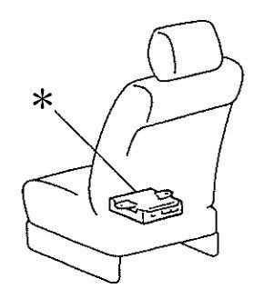

I was fiddling around, cleaning and I moved my driver’s seat all the way forward. Left it that way overnight. Went out to reinstall my clean floor mats and the seat won’t move back. It won’t raise or lower or tilt. Just stuck in the most forward position. Steering wheel tilts and telescopes. What have I done? I read about some button near the fuse box that has a reset switch?

Sorry for your trouble. I don't know there is a reset switch or not but the computer under the seat for the seat position control can be reset disconnecting the battery for several minutes. I'd try it if fuses were all OK. But you will loose the stored memory data for the positioning doing this.Originally Posted by gebo

It was a loose connector under the seat. It looked connected but it wasn't. It was the yellow one.
