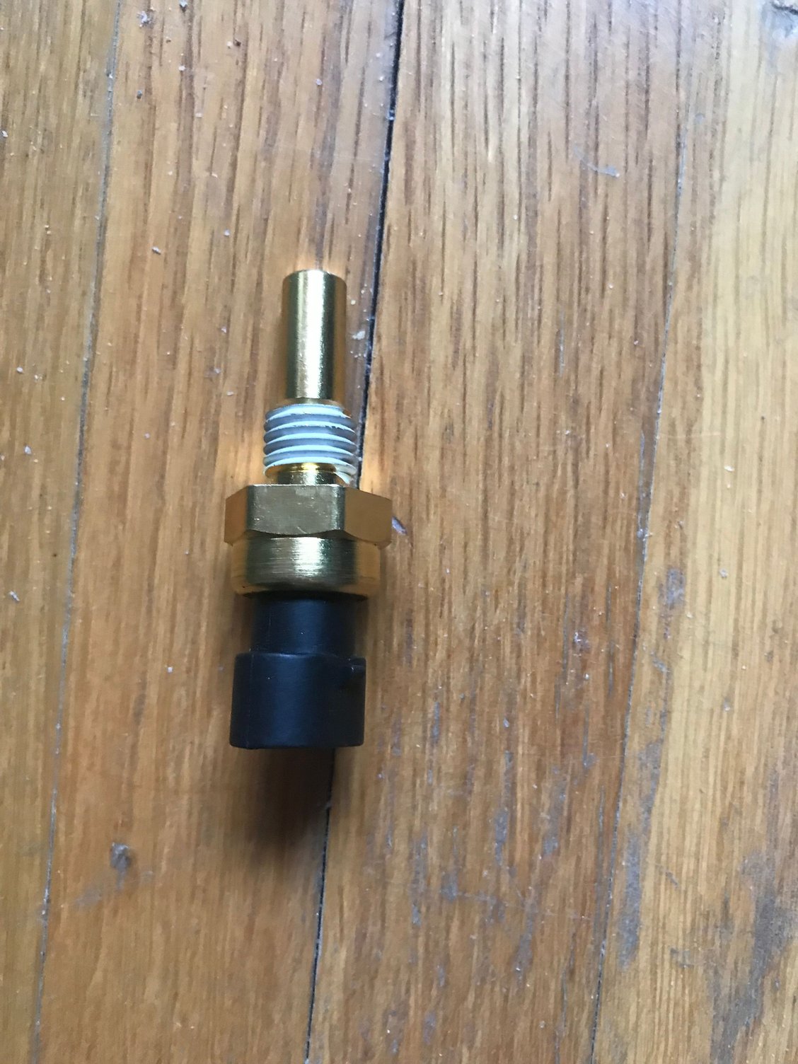

It sounds silly but I cannot find the ECT sensor that I may have issues with. Let me send you a pic of the engine bay. One pic is the new sensor; the other is a part of engine bay.

Thanks for your input. I will try to replace the sensor today. It looks like the ECT sensor is hidding under the rail of ignition cables. I tried to find it on the 1995 Lexus LS400 repair manual (PDF file) but failed.

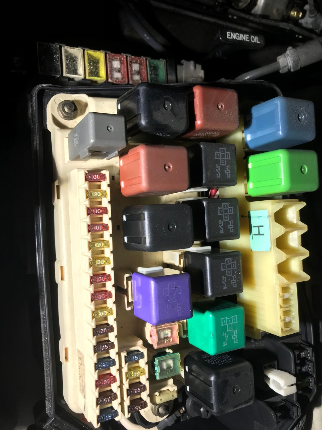

I replaced the ECT sensor but still no start. Cranking is fine but not start. Here is some new findings.
I suspect that the culprit might be of electrical. Then I picked one of the plug connected to the corresponding ignition cable. Then told me wife to start the car. Guess what, there was no spark at all. But the plug was pretty wet. It should be covered by fuel.
1) one or both coils might be bad;
2) or the ignition fuse can be bad too.
Please check the pics attached. Let me know what you guys think. I am not sure which fuse is the one that takes care of ignition. Please advise.

Your whole post is a guessing game.Why would it be fuse?starts when warm and does not start when cold and it could be fuse?Why are you behind the seat checking the fuel pump when you can test for pressure by the drivers side fuel line?No crank sensor code?When it doesnt start when cold check the ignitor for ohms and compare to the other.
