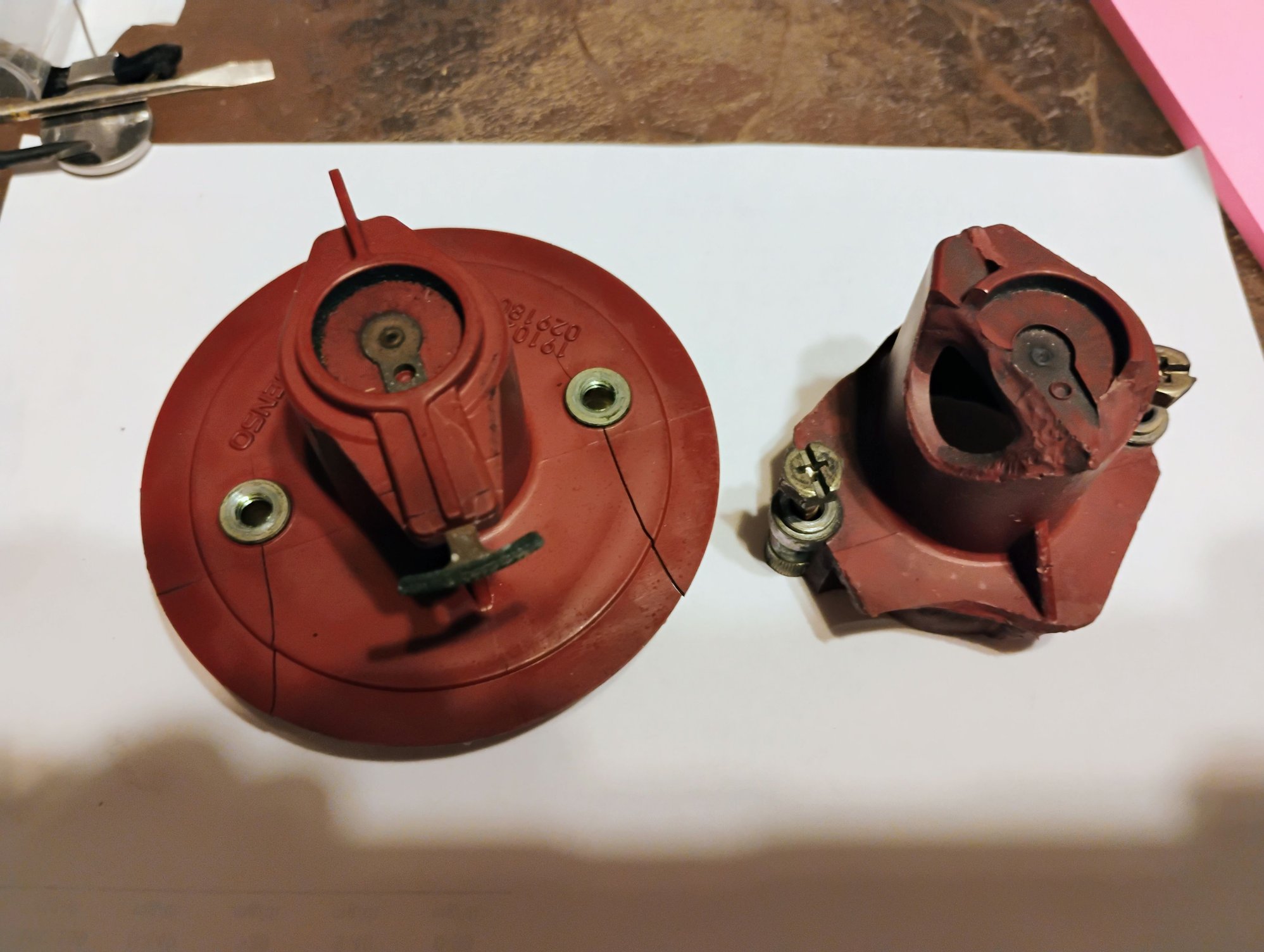

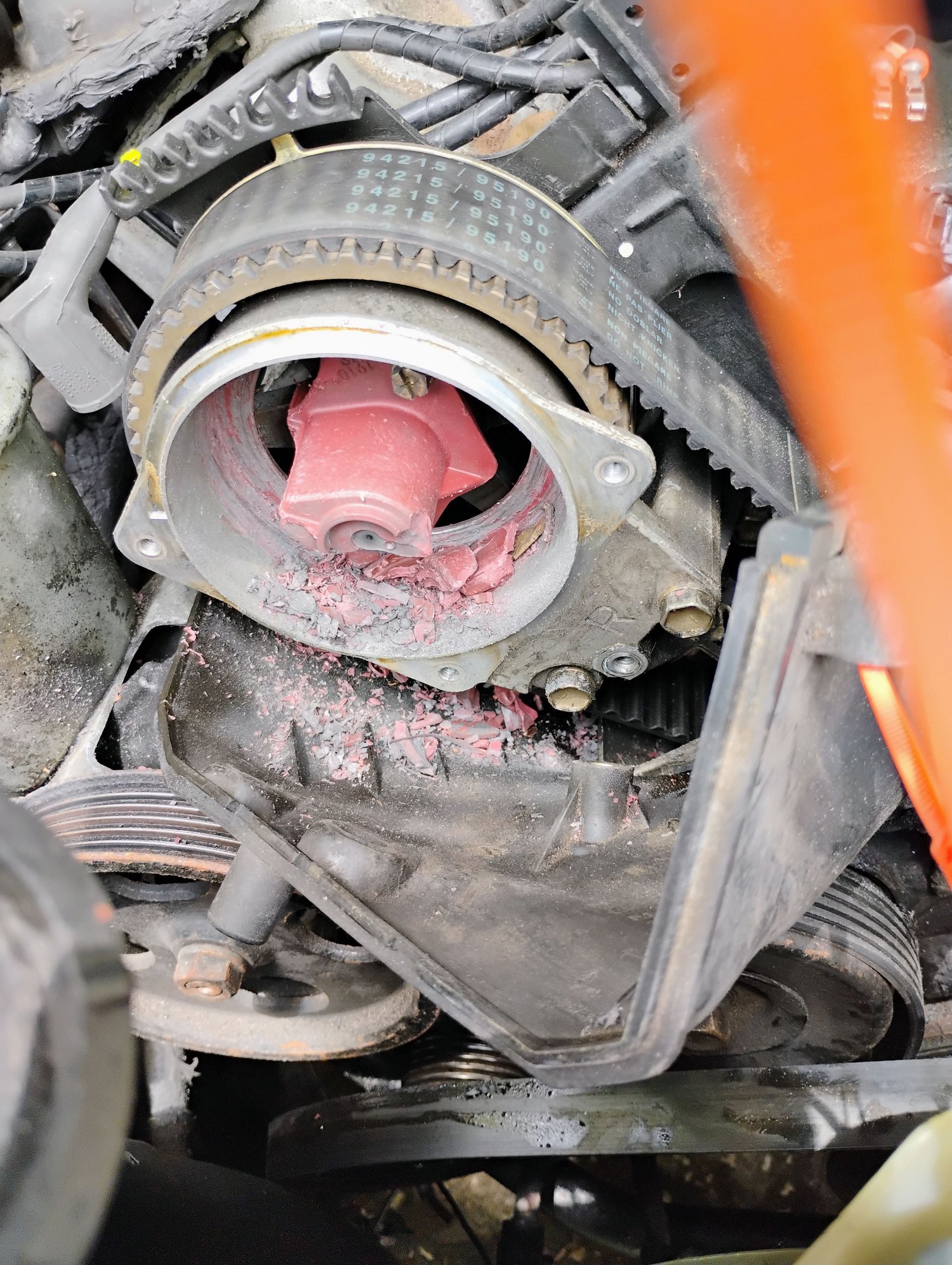

I do believe (although I find it unbelievable) I have finally found the real problem. First I pulled the drivers side distributor cap and found the rotor worn and cracked. But certainly not bad enough to explain this. I replaced it anyway because of the cracks radiating from the screws. Restarted car, no change. Then I decided in bed one night to ground the high tension coils of each distributor individually and try and start the car, To my surprise, after grounding the drivers side the car would NOT start, period. But grounding the passenger side had no effect, car started and ran poorly just the same as if it was connected. So I tear into the passenger side distributor and find the rotor completely disintegrated. See pictures. Is this a known issue? I can only guess that the last mechanic overtightened the screws, they both cracked and the one just eventually came completely apart. The question now is how many of the timing belt covers do I really need to remove to get all the debri out ? I'm thinking I really should remove the bottom timing belt cover as the steel top pin is still missing!
Don't know how I missed your last reply. Good find
Brittle distributor rotors deteriorating is known but it's not a common issue. Part of it could be over tightening, but age of the plastic also could have made this problem worse
Everything is probably at the bottom of your timing belt by the crank. I would start by removing that one first, but you'll need to pull the harmonic balancer.. That will require a puller tool and a special tool (or some ingenuity) to remove the crank bolt. It would be ideal to be at top dead center before you start. You'll be part of the way to doing the timing belt job at that point..
Check out some other threads and videos about the timing belt job before proceeding further
Alternatively, you can try to clean out what you can and replace the distributor rotors for now

Yeah, they tend to crack right at the screw holes (as you can clearly see). Get in there every few years a put your eyes on them. And do not over tighten! I think it's like 8 ft/lb or something in that ballpark.

Funny, but as I read what you did already in the first post, my first thought was "no news on the distributors?" and thought that's where I would've looked next. But then, I do have the advantage of having seen these exact ones, the orange colored ones fail slowly on my car. First they crack, so your timing is a bit off, then they crack some more, and finally you get what you got in that picture - and if your other side is working, you get to drive home on four cylinders, which I don't recommend. The orange distributors are sold by virtually every company - all branding them as theirs, including BOSCH. They are all made by one and the same company (don't remember which one any more), and are BAD quality. They cannot last as long as your timing belt, no way, unless you happen to be incredibly lucky. So plan on replacing these aftermarket distributors at around 45k, otherwise, you'll end up stuck somewhere when you least need it. Oh, and once one side fails, the other will fail too, within weeks if not days, provided they were replaced at the same time.
