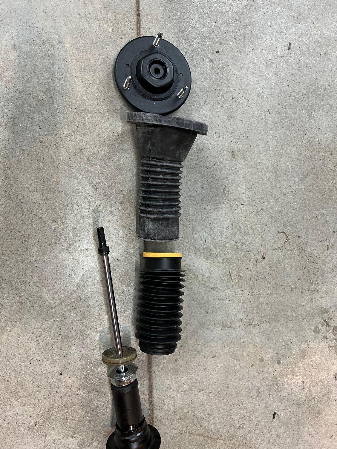

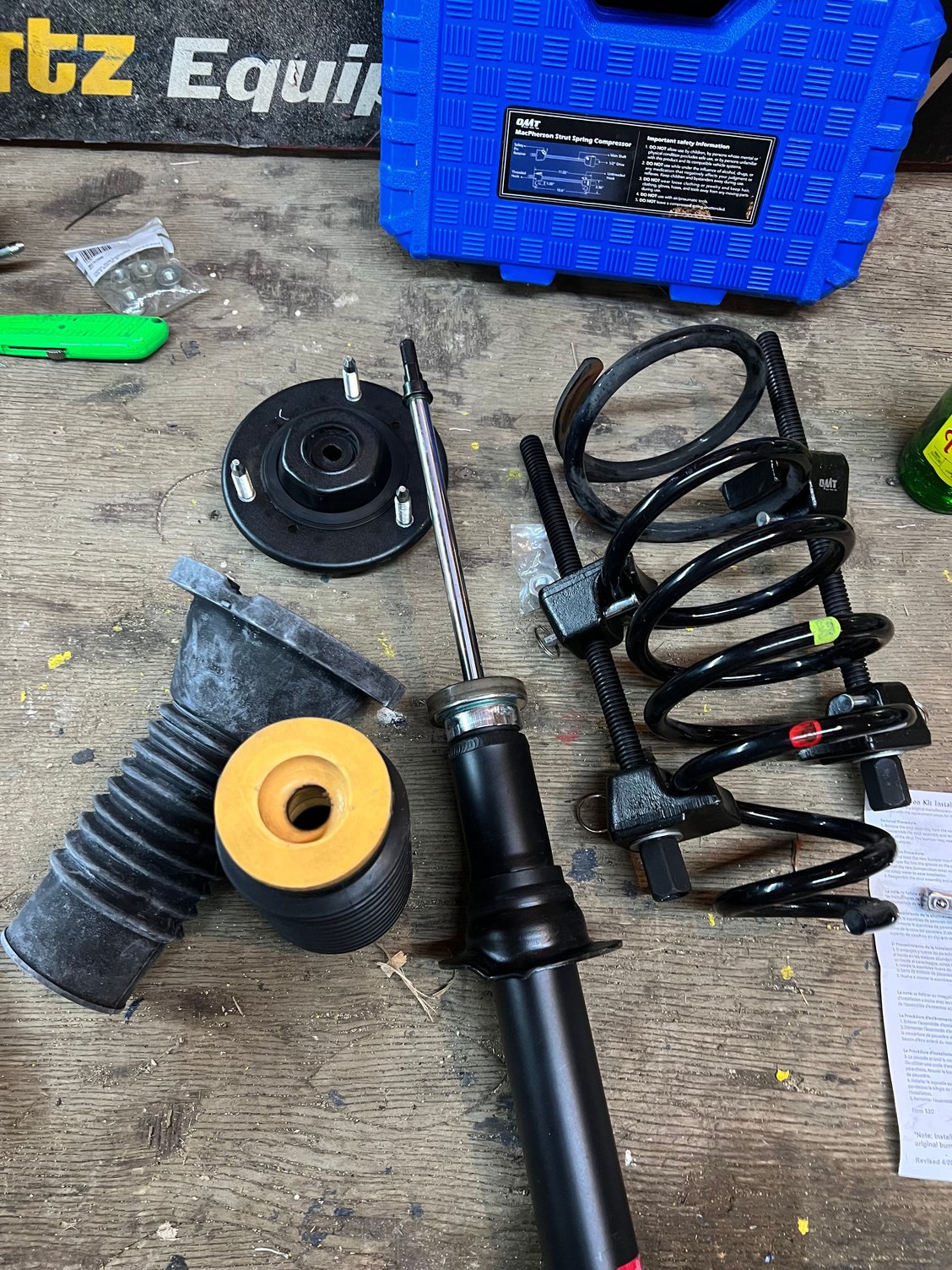

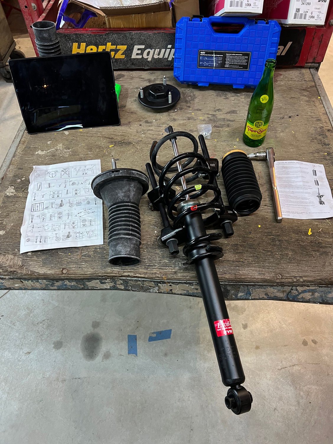

My struts and bellows, etc. finally arrived today. It was a bit confusing but was hoping to post a few pics to see if I have them assembled correctly? I sure appreciate any feedback. Thank you.
I might have to get a 2nd set of the spring clamps to get the top nut on?

just keep compressing the spring (carefully) until it's short enough. also i would reposition the compressors so they are as opposite as possible - i know easier said than done as it moves when tightening.
and i don't think you're suppose to double the dust boot! i would run the new one with the bump stop nearest the top hat.

The boots were confusing because I ordered what I thought I needed but then it seems I somehow doubled up? However, the larger cone-shaped
(Or funnel-shaped) one fits perfectly, fits the top…looks right…but didn’t have any kind of ‘bump stop’ or spacer with it? So maybe I just need to see if the little yellow spacer from the second boot fits into the cone…I’ll try that. I’ll be back to the car this week.
I appreciate your help very much. Thank you.

Update…I’m an idiot. I think when they sent the shocks they sent boots from another car? My OEM stuff came from the Middle East and I was trying to use them both. And once I took the others off the socks compressed easily and I have everything back together and torqued. Now, I take the fight to the backseat and reinstalling it.
