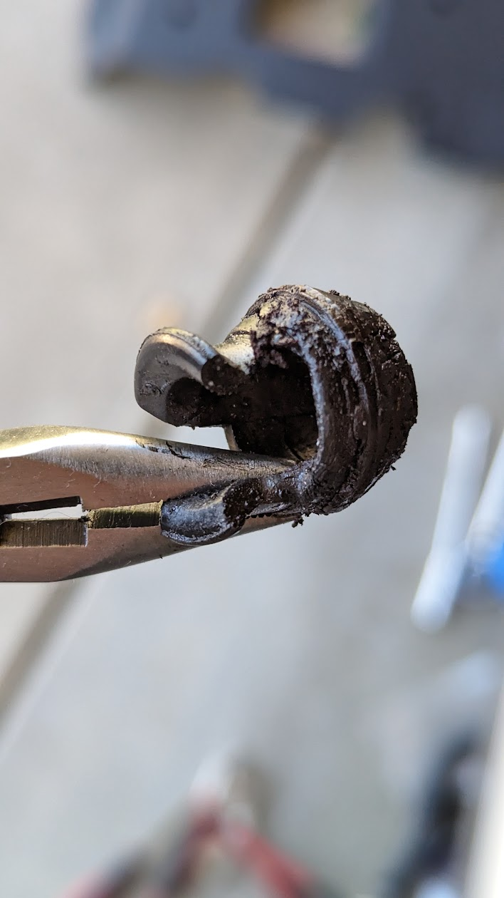

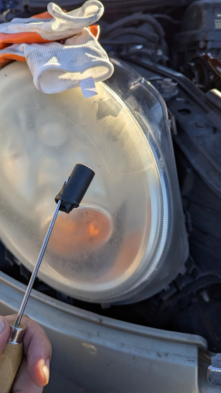

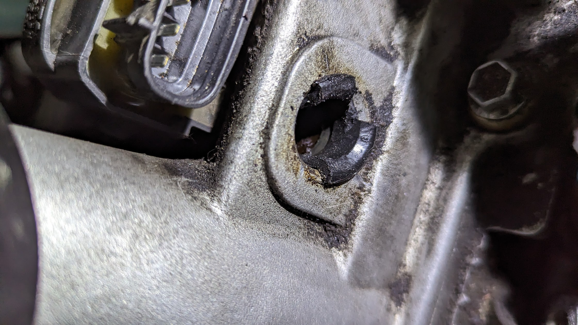

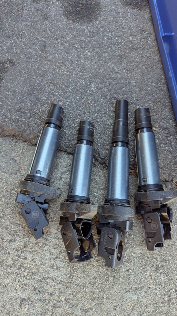

My persistence knows no limits I solved the ECU and didn't give up.
I had 3 out of 4 spark plug rubber insulators break off IN THE SPARK PLUG HOLES and stay stuck in there. Took hours but a pick tool finally allowed me to leverage them out.
And then of course that goddamn PCV valve grommet that took 4 or 5 hours and at least 50-80 attempts to get out, praying it didn't deceintigrate into the valve covers.

Yeah, the only option on those PCV valve grommets is to destroy them taking them out. Can pretty much guarantee that the spark plug seals on your valve covers are hard as plastic and due for changing as well.

The easiest way to remove the P/S pump is to remove the alternator first. It’s only a couple more bolts, and then you’ll have much better access to the P/S pump from the top. This way you can degrease the alternator windings and get a good look at all the P/S hoses. You want to replace any that aren’t in excellent condition. You don’t want to do all the work on the P/S pump and then find a mystery leak in a year and need to disassemble it all again. And rebuilding the P/S pump only involves replacing the seals and o-rings, maybe a couple bearings. As long it never gets run dry, the pump shouldn’t ever seize up or anything like that.
Anytime the PVC grommet gets so hard that it doesn’t easily come out, you should just remove the whole valve cover because it’s a certainty that the gasket and plug seals are also going to be rock hard and needing to be replaced at the same time. And it’s a lot easier to do it all the same time, and its easier to do that grommet when the V/C is on your work bench than on the engine.
