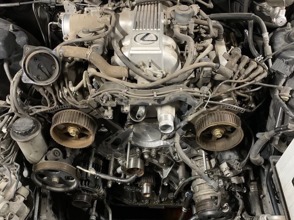

I use the tool shown here to remove the crank bolt:
Then, I turn the crank so that when I attach a breaker bar to the tool, it becomes wedged against the bottom side of the lower left frame (driver's side for USDM)
This allows me to then attach another breaker bar to the crank bolt and remove it
