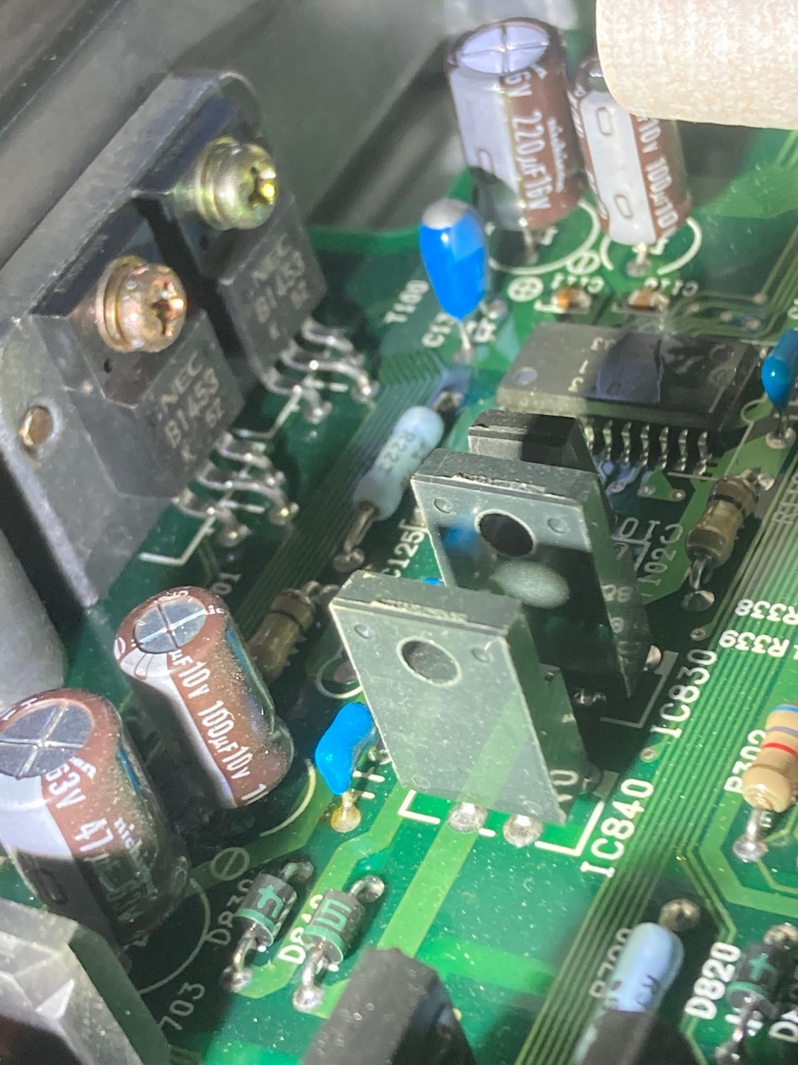

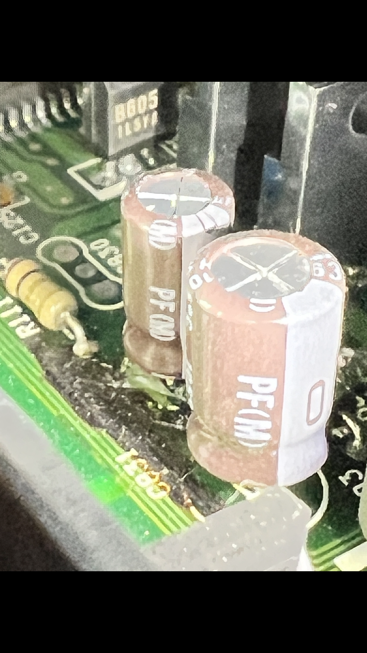

1995 lexus has been running stupid rich causing misfire + smoke from exhaust and gas smell.
Opened up the ecu to find a capacitor had leaked over the board.
I don’t know **** about electronics so if somebody here could advise me on if the board is able to be saved please let me know.
And link to where I can purchase capacitors .
Will provide more pictures later, thank you.

Photos don't tell everything. Intensive continuity tests are needed to judge.
