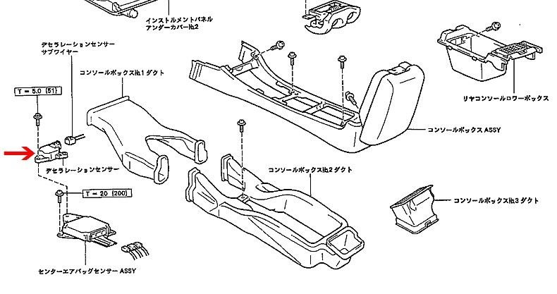

Did you remove the whole air duct? Without doing so, you can't see and access the sensor.
This is perfect thank you

There is one more thing I need to inform you. Sometimes the voltage GL1/GL2 is both very low or 0V due to the reason that the voltage supply VGS(5.0V) is disabled by the ABS/VSC computer. In this case, the troubleshooting is not easy.
