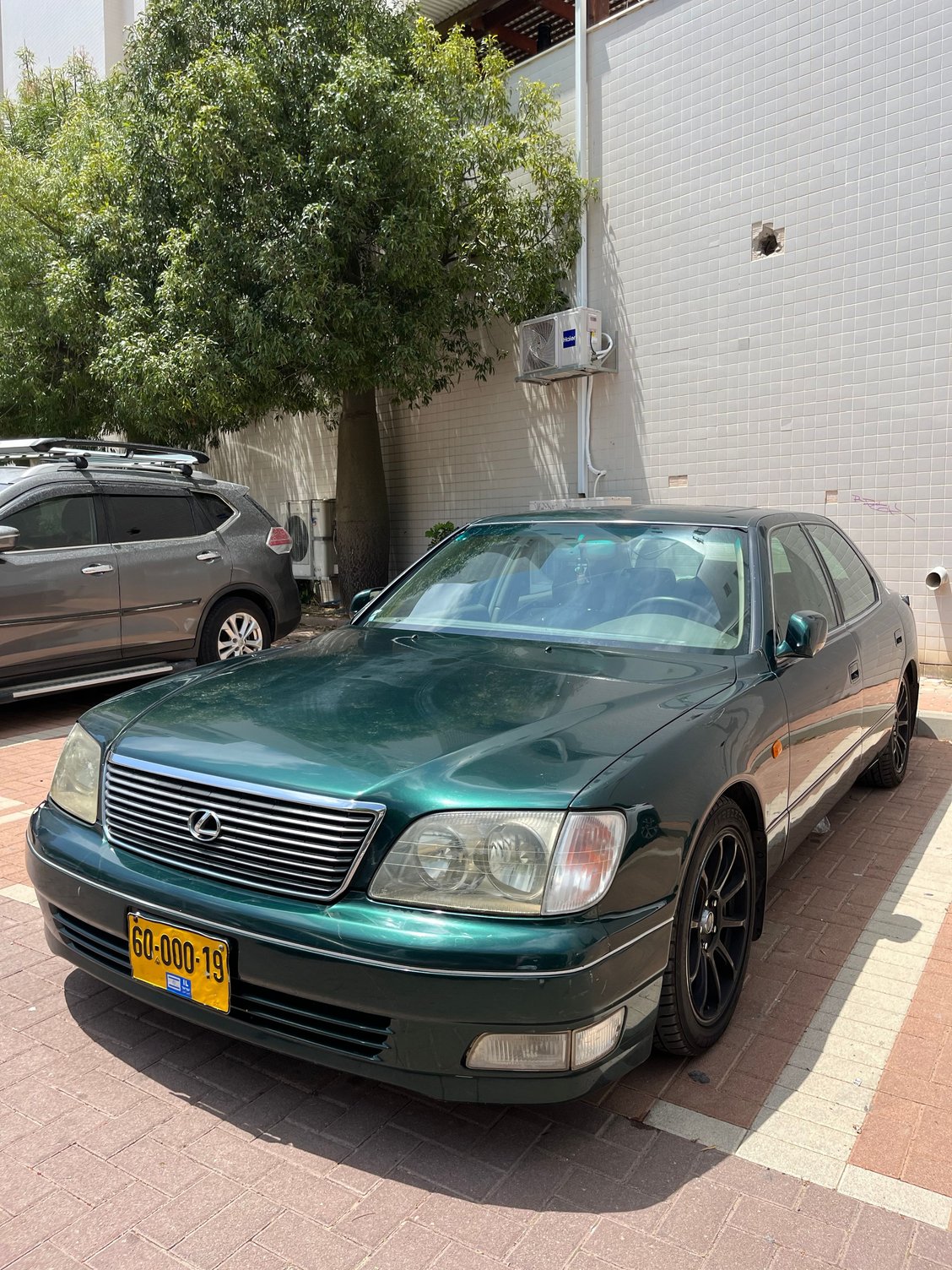

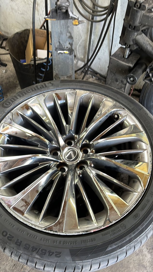

Hey so I want to buy new wheels for my 1999 LS400, I have in mind, the ls500e 20” wheels, ofc I’d need an adaptor but otherwise, is it too wide to even run a spacer aswell? I feel like it’s huge compared to the 400 wheel thanks for the help
attaching a photo for reference
The Ls500e wheel, 20”
Currently running 17”, on 20’s I’ll need to make it less lower

anything will fit with a little massaging! next question is do you want to modify your fenders or keep them stock? do you like a little poke or looking for a flushed look?
because you have to run an adapter to go from 5x120 down to 5x114.3 to fit the LS400, the wheel offsets will be much lower. the smallest adapter i know is 20mm so adding that to the stock offset will yield:
8.5Jx20 ET25 --> 8.5x20 ET5
9.5Jx20 ET35 --> 9.5x20 ET15
from my experience that should fit with a little poke. fender cutting will depending on final tire size and stretch, as well as final ride height.

Thanks!! I’ll definitely need to plan this out to not throw away money and I’m thinking of first getting the serial999 suspension and then mess around with fitment and stuff

I have BC racing coilovers now and godspeed suspension which honestly isn’t worth the money, it’s a bit cheaper than Serial9 but is super wonky and feels like it’s going to break lol
will definitely update! Thanks for the support aswell!
