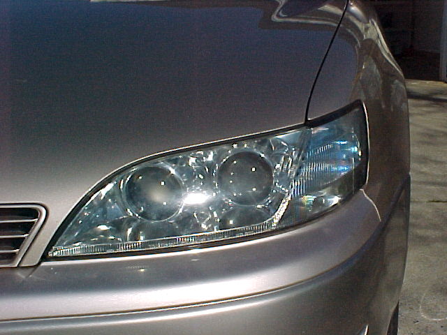

"did my clear corner mod tonight, it was a lot easier than expected
1. Remove headlight (if you don't know how to remove your headlight, don't bother with the clear corner mod at all)
2. Take off all metal clips and remove any screws near the edge seal
3. Place headlight in oven at 200 degrees (made my roomate do this part, haha) for 3-4 minutes, remove from oven and slowly work housing apart with a flathead screwdriver or knife.
4. Repeat step 3 until housing comes apart (took about 3 heating/prying sessions)
5. Unscrew interior housing connector
6. Remove 2 mirrored interior pieces
7. Remove amber insert
8. Reassemble interior parts
9. Reheat
10.Replace clips and screws"

"I finished my clear corners yesterday. They look so good. I will take some pictures this afternoon and post them in the forum. MC's instructions were really good. Only, it took me about 5 heating prying sections. It was easiest to begin opening the side with the signal, then moving to the bottom. Prying that open, then the top just follows. Thanks again. I have a new mod that I want to try now. About a year ago, I wanted to put some knd of light into the housing to make the entire housing glow (much like the IS parking lamp). I had no ways of doing this (that didn't look horrible in the daytime) until I saw the wire that glows neon. I was thinking about putting the wire either around the canisters, or around the outsied of the housing, and wiring it into my parking lamps. Does this sound do-able? Has anyone tried anything like this?"

Default Photos
Clear Corners (Eric's car)
