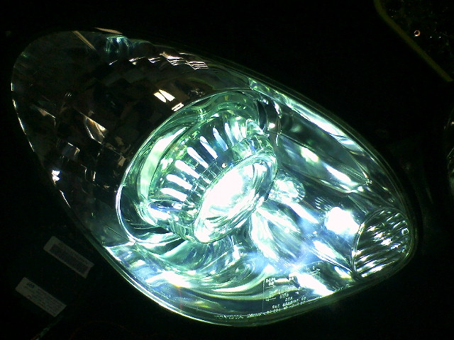

.. a retrofit that is .
Inspired by the following thread from a year or so ago, my next retro is a set of M45 projector (with E30 clear lenses) in 2GS headlights .
I wont be doing the retro anytime soon since i dont have any spare headlights and every where I look people want an arm and a leg for a set ...
Do we have any donors?? I mean does anyone have a spare set that they want to donate to this cause .. lol condition dont matter.. Looking for a set of halogens for less than $100 ( i know i am asking a lot but it never hurts to ask) ..

Heres a preview
Originally Posted by PHML
This thread will eventually be moved to Lighting section...but for now...lets leave it here.
Saw this on Japan auction site..... UNBELIEVEABLE!!!
Last I saw...it was $2500+....includes auto leveling feature. Enjoy the pics.
Pete
original thread
https://www.clublexus.com/forums/sho...d.php?t=228686

How much did the e30 lenses improve the M45 projectors? Haven't seen that lens swap combo before. Those are cool shrouds.
Isn't it fun to retrofit 2GS headlights? They fit any projector you want! Can't say the same for the highbeam side though.
Old Feb 23, 2008 | 08:57 PM
emoshun's Avatar
emoshun
iTrader: (11)
Joined: Sep 2006
Posts: 2,370
From: Cali
It should yield the same results as when I swapped in a TSX lens.
You have slightly increased intensity, and a sharper bluer/greenish cutoff.
Overall a major improvement!

Those are some nice looking projectors.Any beam shots with the lens swap?

I'll have output shots in a day or two. I need a set of headlights to retrofit these into, anyone willing to help?
To add my personal touch to the retrofit here is an idea, a custom parking marker/indicator?? What do you guys think, 12 LEDs installed in the GS bezel. The circuitry would be hidden underneath the bezel where as only the illuminating heads would pop out from the bezel.
A quick wire up that I did
These suckers are bright .
