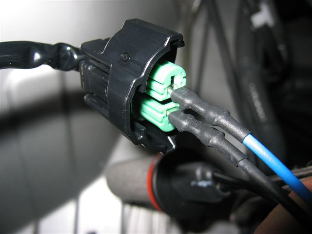

are you sure you're getting a good connection on the passenger's side? does your kit plug in directly to the OEM headlite plug or are you inserting the leads into it like this photo?
its like that (inserting the leads).
i've tried every possible combination of ballast/bulb/harness possible with this kit and the problem only happens on the passenger side.
it's a cheap no name brand. if all else fails, i'll return it and get something better.
